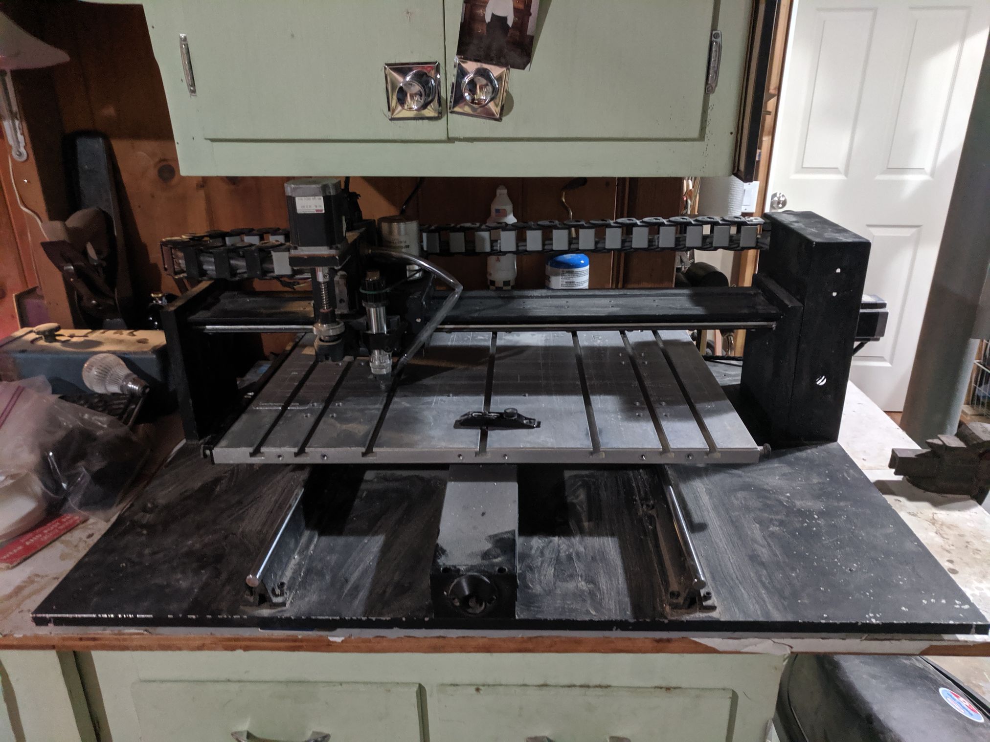

For reference, here is a photo of the machine shortly after I received it:

From that photo, it does look like it would be a challenge to retro fit it for a router spindle.
Some closer photos of the spindle mounting area and the Z-axis mechanism would be helpful.

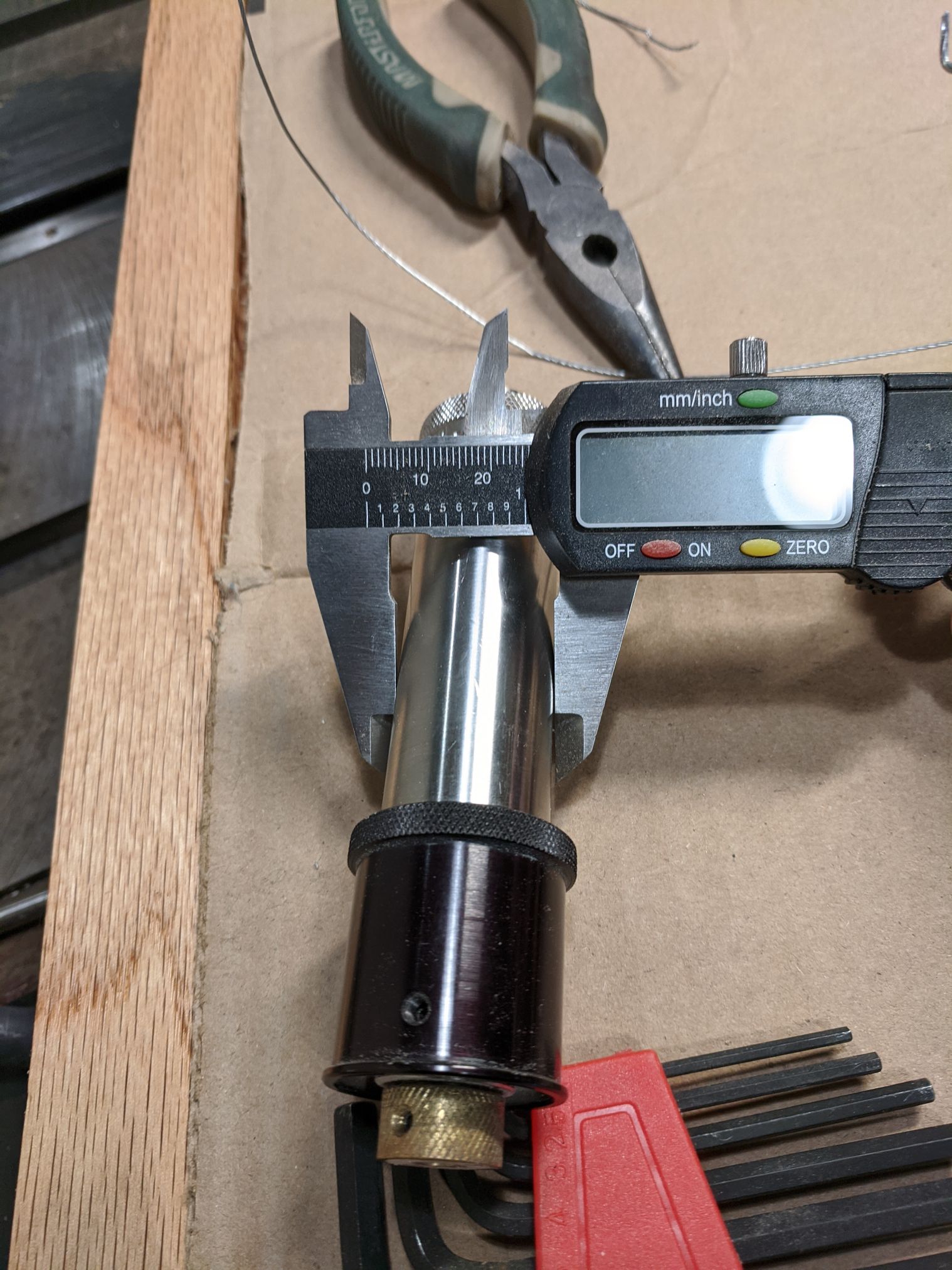

The engraver bit can be seen here:

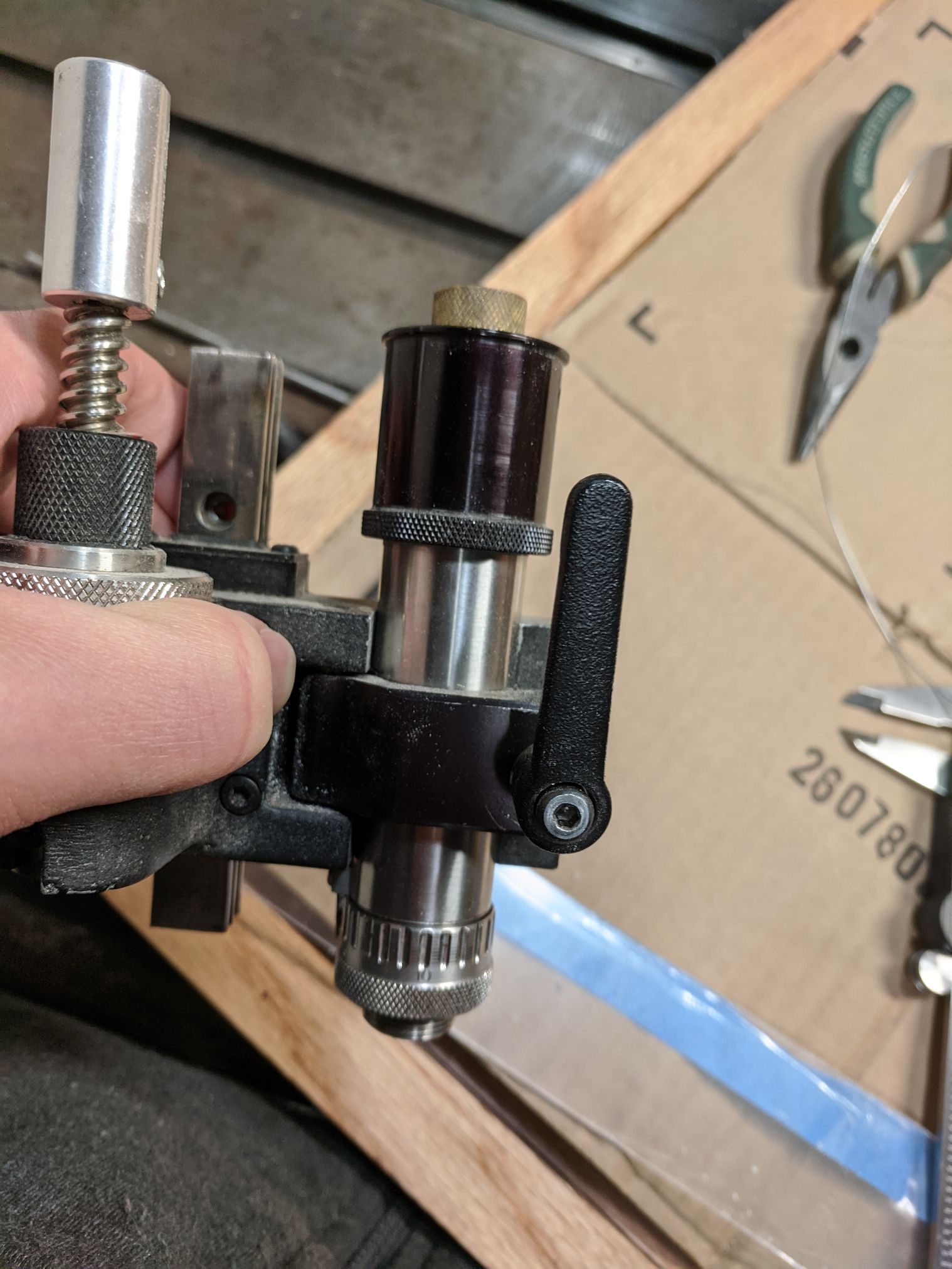

It is 150mm long and 6mm in diameter before the v-ish bit at the end. It feeds into the belt-driven spindle:
which is clamped (25mm shaft diameter) to the z-axis slide:
Upon re-investigating the spindle, I don't think it drops in from the top because the cutter wouldn't fit through the 6mm bore in the spindle. However, it is tightened at the top with a setscrew.
I don't have any closer photos of the z-axis carriage on hand, but I'll try to get them tonight to further illustrate the situation.
I have a theory on how I can convert it to a collet to hold end mills, but I'm not sure it will work. I'm looking to find a length of 6mm steel rod to feed through the spindle and secure in place with the set screw. Then, I'll attach something similar to this (with the correct 6mm ID). Thoughts on that plan?

I've been searching for C6 ER11 Collet Shanks and I've been finding items similar to what you found. The issue is that the 100L is 100mm length and if I feed the current cutter into the spindle, it really needs the full 150mm. It seems the longest length I can find for a C6 is the 100mm. This is why I'm leaning towards putting one together right now.
If anyone knows of a supplier that has a 150mm C6, I'd love to hear about it!

I think the tools would have to go in and out of the top. All the engraver bits like this I've seen are straight (1/4") diameter the full length including the tip. Also there is no provision to raise the spindle high enough to be able to pull a tool that long out of the bottom on your machine.
I'm not sure that that one little profile way your engraver head rides on will be tough enough for routing either.
