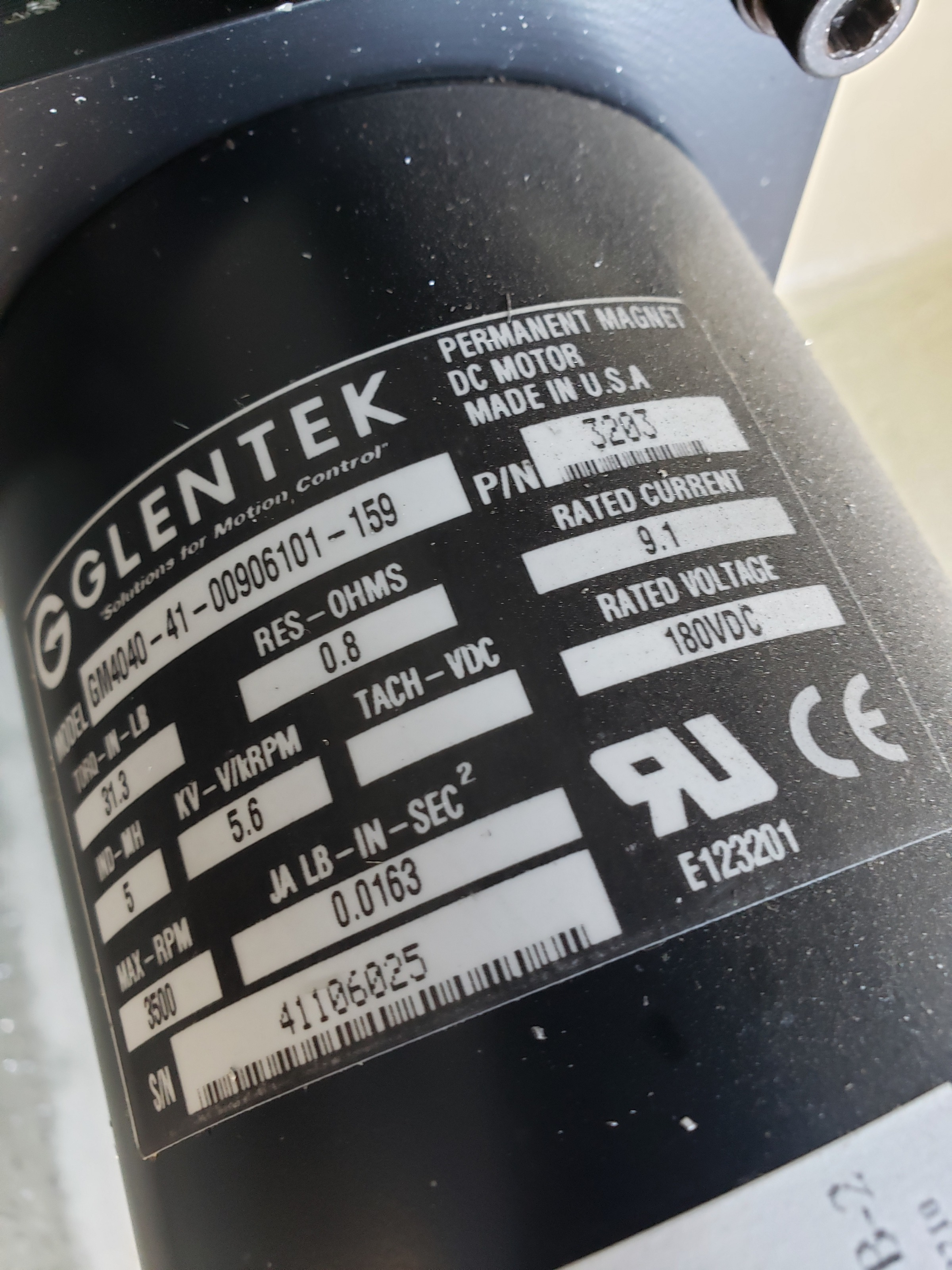

I just purchased a bostomatic BD 18-2 from NASA. The machine doesn't have any of the axis drivers. Since I'm going to need drivers I'm planning to upgrade the machine to linuxcnc. The servo motors are Glentek GM4040-41-00906101-159. I need to find some drivers capable of running these servos preferably reasonably priced. Also I really need to find some writing diagrams for the upgrade.

Find us more information on the motors, please.

I'm including a picture of the motor id plate, and the pdf spec sheet.
The motor is brushed rated 180vdc, 9.1A.
I decoded the model number.
There is no brake installed, no tachometer, and a special encoder.
Thanks for the quick reply

The motor is easy to deal with, but that special encoder is not, as there is no info on it.
For the drives, anything from GeckoDrive.com with limited speed for 80V, Pico-systems.com has some 120V ones, Mesanet.com has 7i29 that is a dual 165V drive for two motors, etc.
One option is replacing those encoders with normal incremental ones.
There are other parts that should also be included depending on encoders and the choice from the above.
