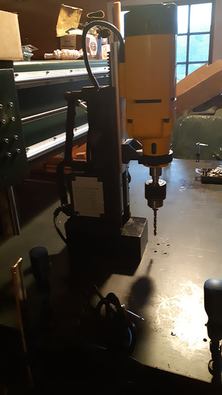

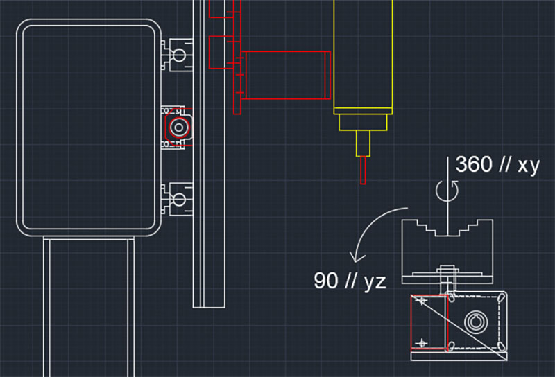

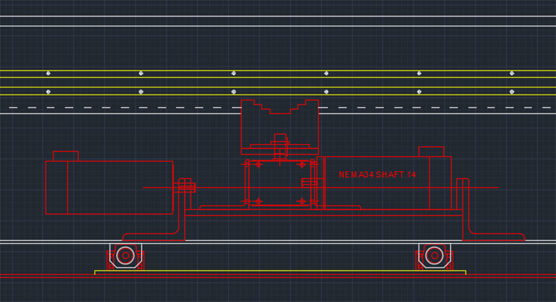

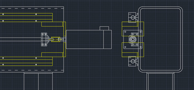

I almost finish building the structure of my new cnc machine.
The machine at this point is basically a 4 axis router pushed by nema34-12Nm closed loop stepper but, my final goal is to add another 2 axis.
I have another similar machine (router 4 axis) that I built out of wood and controlled by mach3.
Now I want to control this new machine with linuxCNC and in prevision to add another 2 axis I'd like to know if someone can suggest a suitable "brain".
Thank in advance for any help.
Regards
V.
