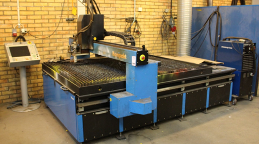

I am newbie on CNC machines but somehow I managed to buy a huge an old plasma CNC machine (Vanad Kompakt 1500 from 2001 with MEFI 836 CNC control). It works now but it was no electrical documentation for it so my plan is to exchange control system for it.
As it is now I'd would like to keep the servos, tachometers, encoders to keep the costs down.
It has double PMDC motors for X-axis, one PMDC for Y-axis. The Z:axis has a simple car wiper motor.
The PMDC motors is 24VDC,5A,80W and have separate tachometers and encoders (TTL Quadrature).
(The plasmaburner is not working so I'm planning to rebuild the machine to a milling machine so I will mount a spindle motor later on.)

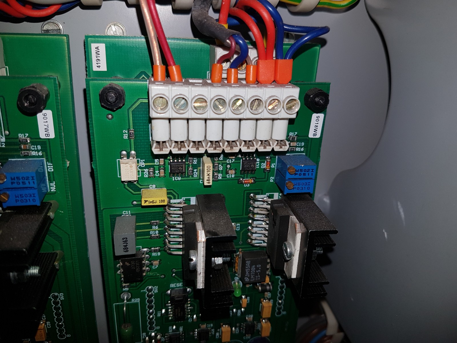

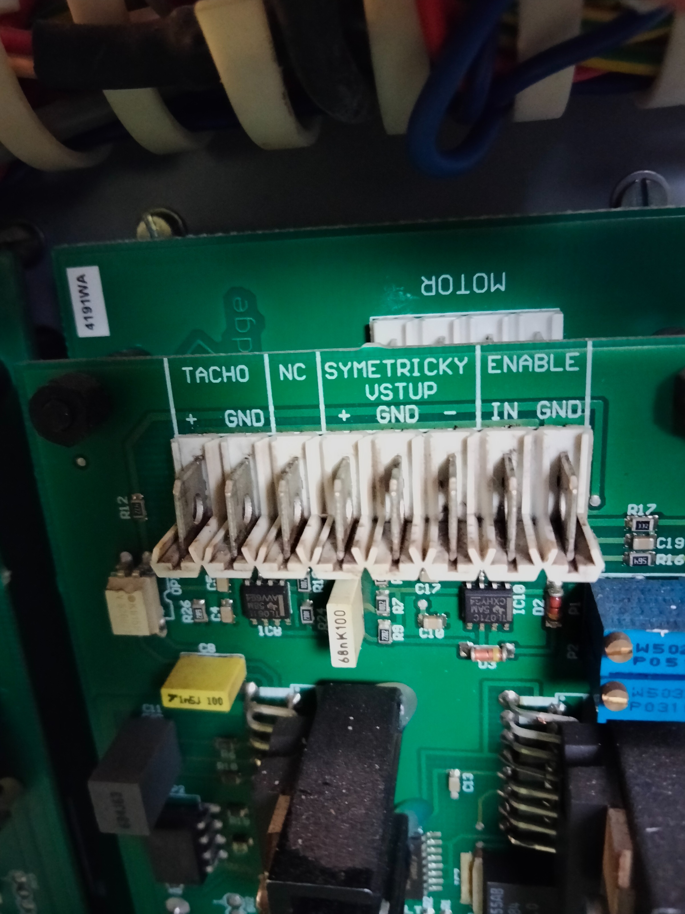

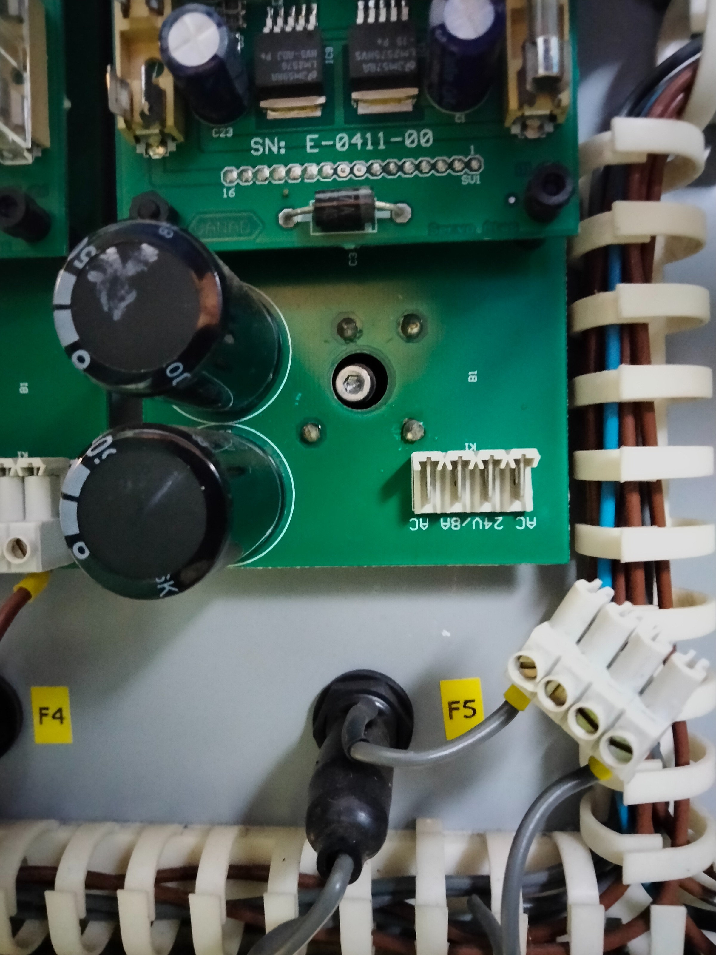

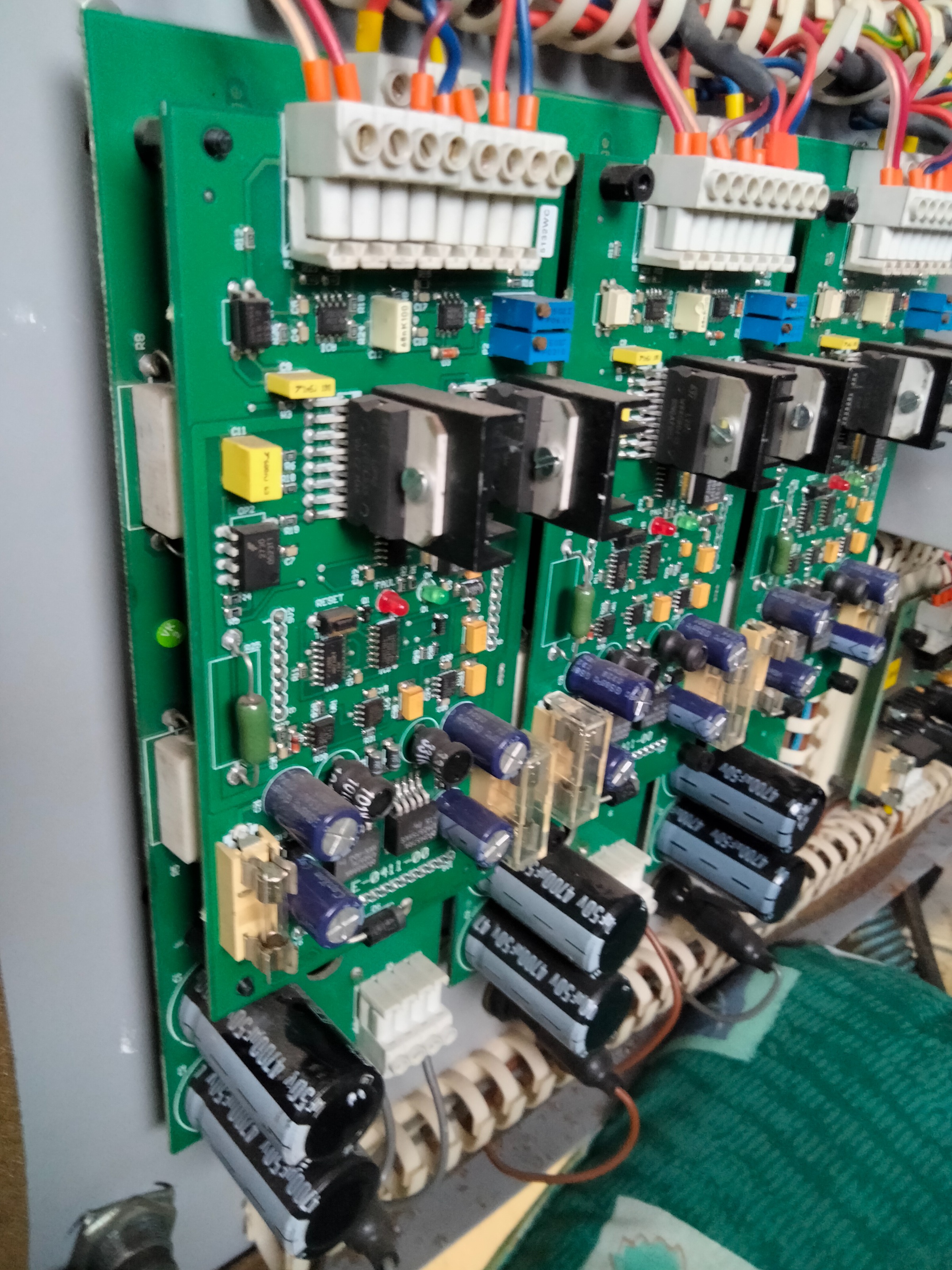

I've taken some photos of the motor drivers and luckily when remove the clips it was labeled on the the card so that made it a little bit easier
Started the machine and a found out that one of the X-axis drivers isn't working so it only drives with one motor at the time..
One of the fuses on the driver card is blown and it seems to be some shortage that I haven't been able to find which component that is faulty so I guess a need to find a motor driver card for that motor. Grateful for any tip for a good driver card.
The encoder cables are connected directly to the PC and the tacho are wired to the driver card.
When measuring "SYMETRICKY VSTUP + & - " (see picture Drivercard labels) I get -3VDC to 3VDC. I have only managed to manually jog the motors and there is a speed settings in manual mode that goes from 0-3, so I'm not sure if it possible to drive the motors with -10V:10V.
Maybe it's speed limited in manual mode and that is why it only is -3V/3V?
Have a Raspberry pi 4 with LinuxCNC on so I've thinking of buying 7i92M and a 7i77. Is that an ok setup or should I get hold of a PC with parallel port and go with 5i25 and a 7i77?

Symetricky Vstup = symmetrical input.
How exactly did you measure the input?

Measured DC voltage over "+" and "-" see attached picture.
Also same voltage over "+" and ground "GND".

- and gnd ? Always 0 ?
- Norrby
- Posts: 8
17 Sep 2021 16:30 #220950
by Norrby
Replied by Norrby on topic Help with selecting hardware for CNC retrofit
Yes, no voltage difference over "-" and "gnd" when I run the motor.
I will check the motorspeed tomorrow when it runs on max (3V) and see if it comes up to 2000rpm/min as the motordata says.

Nice, so it is an analog drive with +-5V or +-10V , so a Mesa 7i92 with Mesa 7i77 should do just fine or go for the Mesa 7i97 as it has both on the same board.
BTW, if you go the Mesa 5i25 or Mesa 6i25 with Mesa 7i77 route, there is no need for a parallel port.
