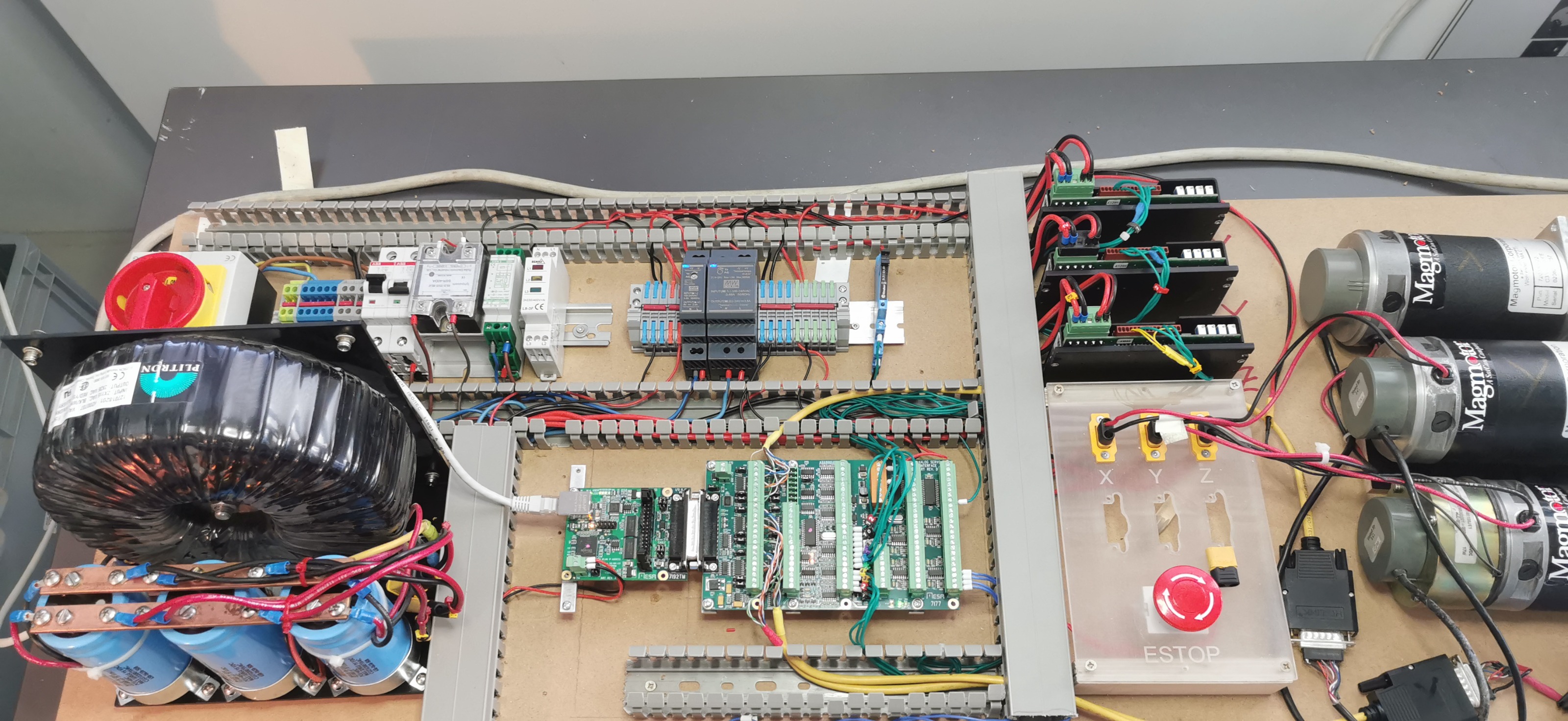

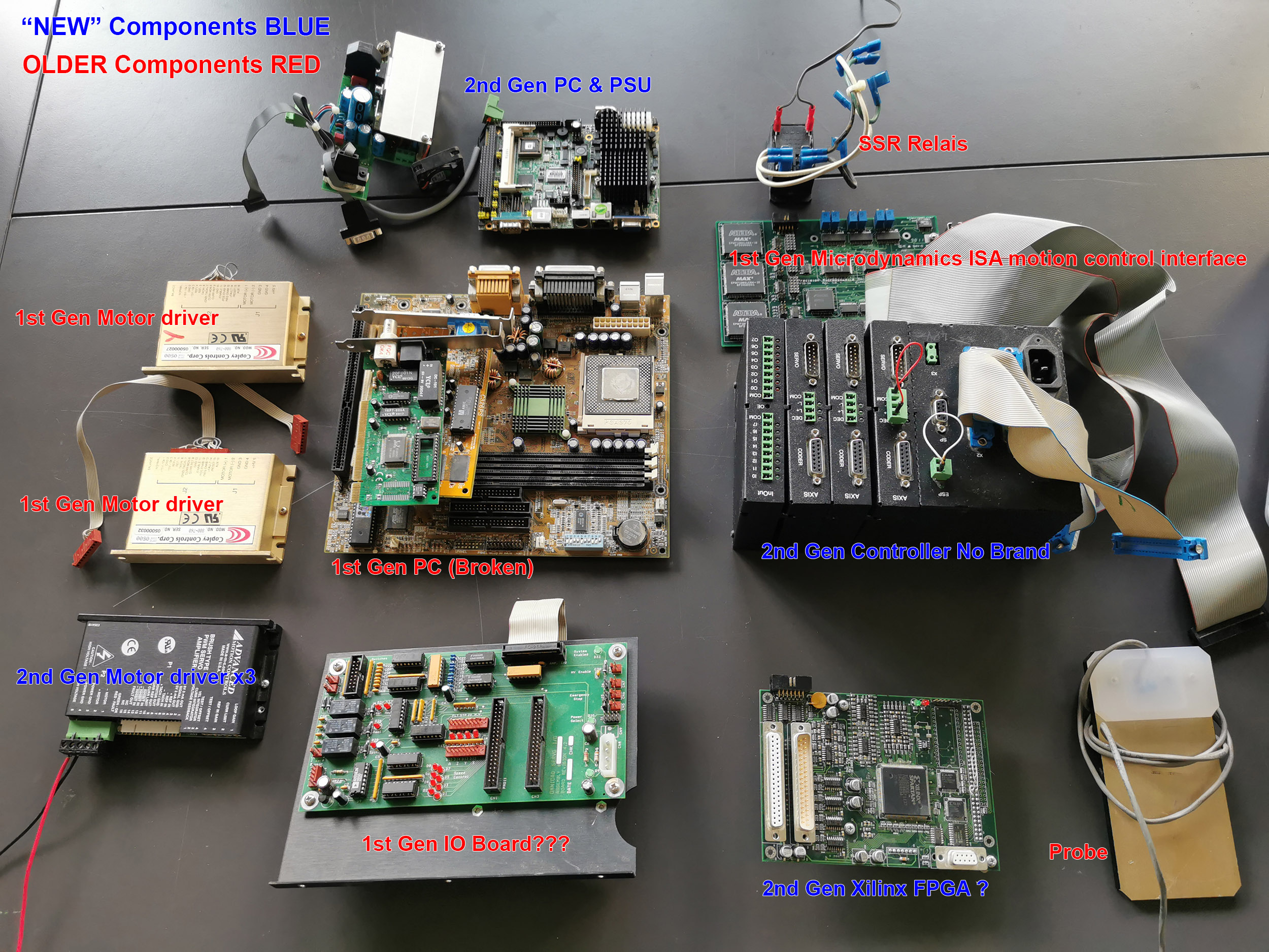

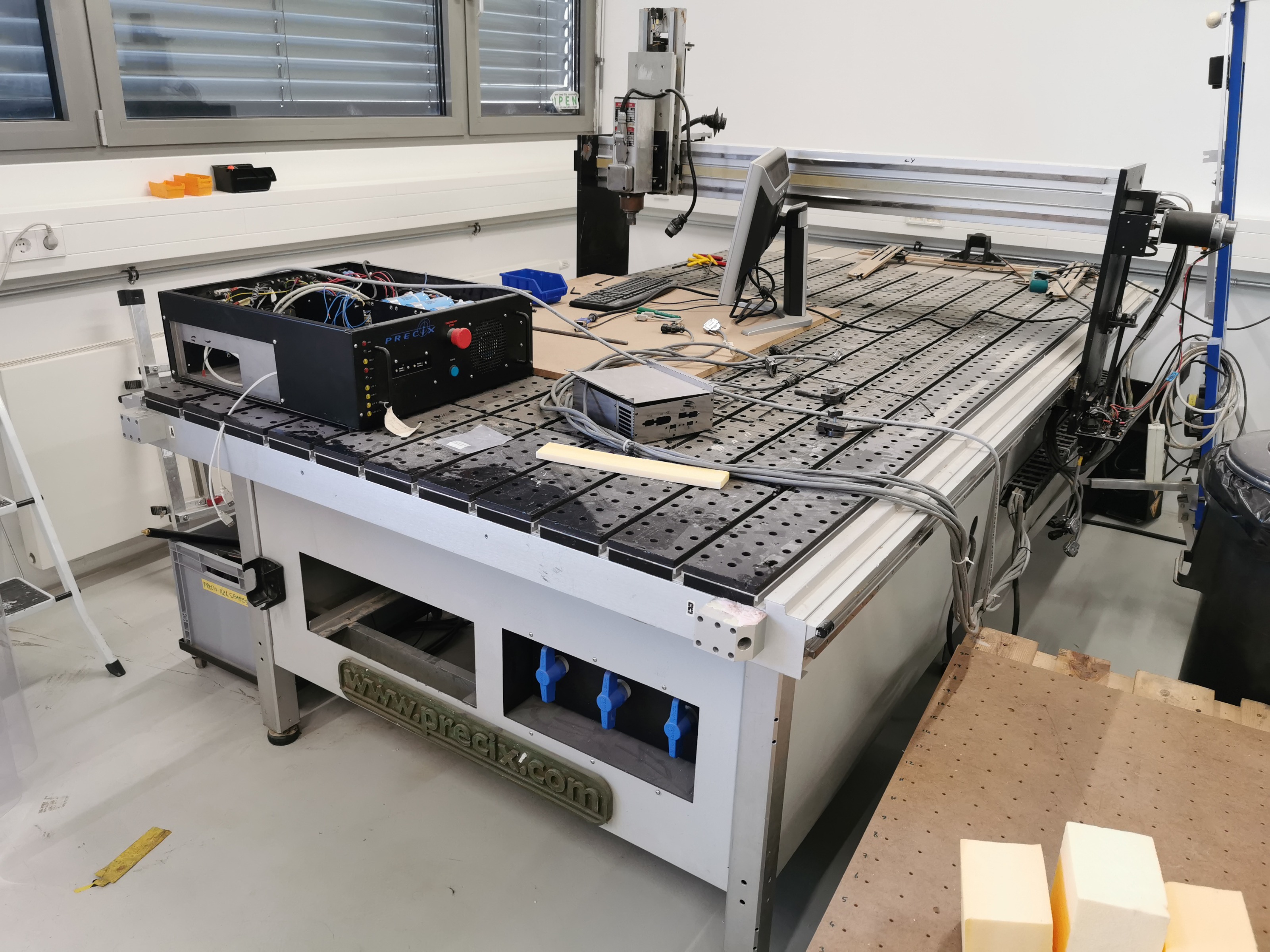

We got a precix 3Axis Gantry mail in our department (University of applied arts vienna), which i want to give a 2nd life as the controller was broken for years. The mill has 3 DC-Servos and a 2.2KW Colombo Spindle
I Started it in Feb. 2023. Learned a lot over the summer and set up a new controller with new electricity but mostly relying on the old components (PSU, Motors, Spindle/VFD, Drivers are original). Controller is a mesa 7i77/7i92t.

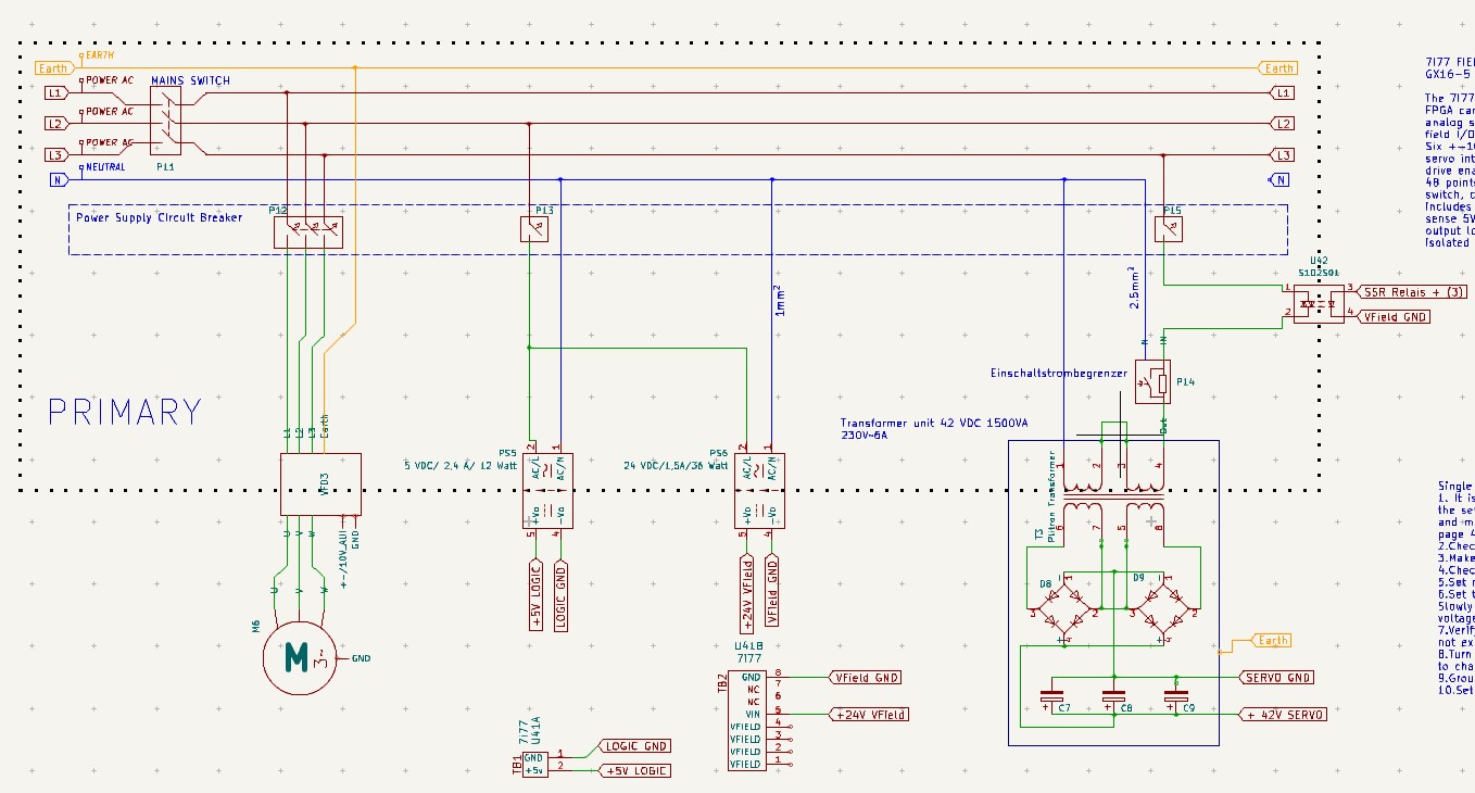

Also learned to draw electric/electronic blueprints with KiCAD which was a great help
With the help of the forum I managed to run first G-Codes on the plain setup board (disconnected from the machine ) last week.
While tuning the motordrivers i ran into issues constantly tripping the breakers in front of the servo psu which is a beefy toroidal transformer(1500VA). Tripping happens when turning off! the PSU 1 out of 3 times. Also my ssr was blown already - maybe not a good idea i found out already.
So here is my question:
Who has more experience with induction/overvoltage issues running an old psu?
Suggestions for improving the electrical layout is appreciated, as the machine will hopefully run in an university environment again and i am not a trained electrician #safety.
I also attached some images and a schematic of my current controller setup.
Thx,
Armin

If this statement is correct, the only thing i can think of that would remotely be able to do that is having all the motors and drives enabled and under load when you switch off the machine. Still to far fetched, and very, very low chances.
-edit:
RMU reminded me that even this is not possible due to rectifiers not allowing back powering the transformer.
Thank you RMU
-end edit.
Tripping normally happens on power on, not power off.
Are the drive enables wired and set up properly in LinuxCNC?
The drives should only be enabled when pressing F2 or "machine enable" on the GUI. Othervise they should not be enabled.

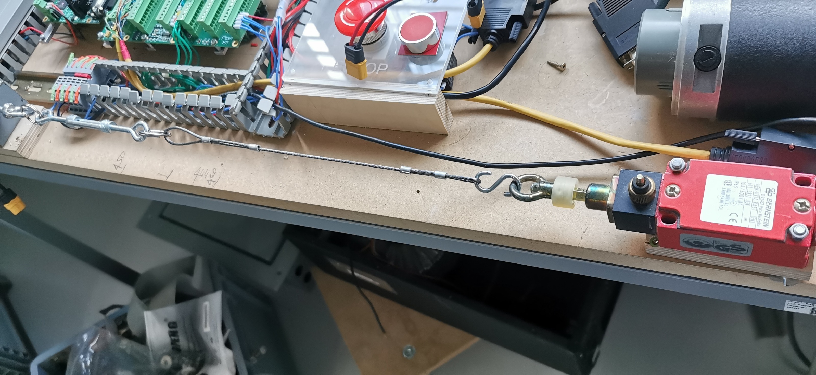

Those are DC motors, so another question, does the machine have "extreme limit switches"? These should be separate from all other limit/home switches, and should cut the power to the drives if they are tripped.
These should be mandatory on brushed DC motor powered machines as any short on output mosfets inside the drive will send the machine at full speed in some direction.

You trip P15 when turning off? That is odd. Does P15 come from the original box, what type is it? Overvoltage should not trip a breaker, they trip on overcurrent, how quickly they react depends on overcurrent and type of breaker. But overvoltage will damage your SSR. Maybe get a beefy relais or a contactor ("Schütz") to switch the Trafo if you have to.
Also I would check the "Einschaltstrombegrenzer" is working properly.
In general it looks very clean, but you will have to put it into a box, main switch must be reachable without opening the box.
I would keep wires with line voltage separate from the low voltage stuff and mount some sort of shield over the open busbars (e.g. acrylic) or at least some isolating tape, to prevent nasty molten metal flying around in case somebody drops something...
Regarding safety: E-Stop button should be reachable by machine operator. From a "Maschinenrichtline" POV this thing will probably never be OK without a cage around it that inhibits any motion if door is open and some type of dust extraction, depending on materials you are milling. Dust from MDF and some hardwoods is nasty and IIRC cancerogenic.

tommy, that can't be. Even when all drives are running full power, they could rise the voltage on the DC side filter caps beyond their limit, but the DC bus can't back-feed into the transformer because DC doesnt go through transformers also there are the rectifiers.
I suspect wrong type of circuit breaker and or some fault with the inrush current limiter. Or maybe some miswiring but hard to imagine.

You might want to try a MOV across the input to the transformer. Something is going on if it took out the SSR.

Usually with toroidal transformers powering on is the critical thing. The iron core can retain magnetisation and if polarity when turning off is same polarity when turning on the transformer looks like a short-circuit for up to a half wave (10ms) and that is what trips the fuse. This effect is particularly strong with toroidal transformers. wikipedia has all the details: de.wikipedia.org/wiki/Einschalten_eines_Transformators
That short-circuit type situation can't happen when turning off, so I'm puzzled.

We have frequent inrush current issues with "B" rated breakers inhouse. our house electricians refused to put slower breakers.
So tripping goes down from my Controllber P3 (10A C-rated) then my Lab breaker (16A B-Rated) and the first house breaker ( 16A -B-Rated). All together. No FI t(guess RCCB in english) tripping, of course - walk of shame when it tripps. This ratings define how fast breakers trip A-B-C-D (not sure if you have this in US?
Old Powerbox was 110/230 mostly with 20A Fuses no breakers, a schütz for Vacuum else nothing special.
For now i just run the motor driver without Mesa Fieldbus and Logic Power
Checked the old setup in it was almost the same, also a very standard SSR to switch, but two NTC's instead of the P1 Current Limiter.
DC currents are super low as there is no torque on the motors.
Thanks for your thought on backfeeding the toroid from the motors/Caps, this should not be possible right?
@tommylight
On the test setup the ssr is controlled by the red emergency button. This failures were mostly driven by switching via the ssr. Might be an issue switching when driver is still enabled. On Linux enabling works fine as you described.
The machine just had homing switches no min/max switches. The servo loop worked fine so far, inhibit/fault seem also ok Z-Axis has a break, X,Y run out when driver gets disabled. But thanks, about the mosfet info . So i should put relays in between PSU and driver not! controlled by LinuxCNC?
@rmu
Also thx for your comments. My understanding so far: The primary side of the toroid induces a voltage peak when turning it off. Maybe together with a high current? it flows backwards through the breakers. But how when switched off? The SSR must be faulty or too slow. Or only half of the sine is switched, one mosfet broken? Ok the Voltage kills the ssr, the current tripps breakers. With a mechanic switch there should be no way to flow back. But i liked the ssr
And what i understand from your comments the secondary side has nothing to do with these issues. That helps.
The "Einschaltstrombegrenzer"- nice German
should not have any effect as it should be switched through at the time.
Thought of using a NTC instead (switches with heat), not sure.

We mostly do 3D landscapes on prototyping foam aka Sika stock is up to 300mm. We were forced to get a new filter extraction. Even though we hardly catch the chips/dust at the tip as any hose close would mostly hit the stock. Also the machine is open on all sides - an issue - we separated the mill with a thicker curtain (transparent plastic) from the operator - what i am testing now is steel wire around the machine connected to estop switch (picture). Nothing which complies with safety standards - we also have a small robot standing around which is even worse

Cutting power to power supply mains should be controlled by the "extreme limit switches" and the E-stop.
Drive enable should be controlled by LinuxCNC, but you have that sorted.
E-stop can also be wired to be controlled by LinuxCNC, but if you do implement this, the extreme switches take priority, always.
