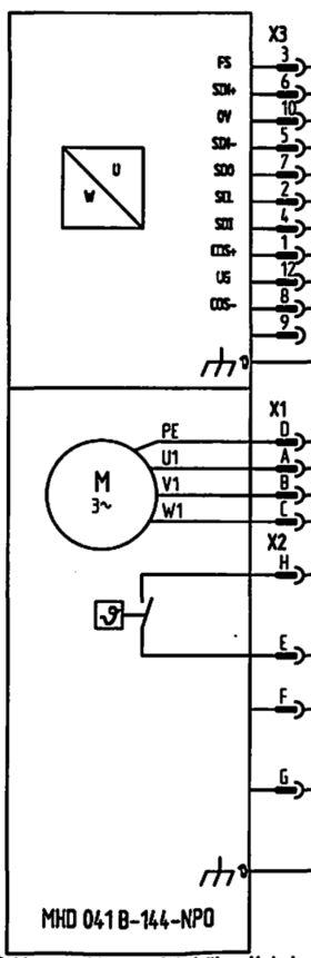

Do the motors have tachometers? A dirty tachometer commutator might explain the behaviour

I don't think so. It appears to just be a three phase brushless motor with integral encoder. Here is how the schematic shows the y-axis motor:
Looking up the part number, it is described as:
MHD041B-144-NP0-UN by Rexroth, Indramat, Bosch is a Synchronous Motor in the MHD Series. The MHD041B-144-NP0-UN features a Motor Frame Size of 82mm Flange Size, 50mm Centering Diameter and a Motor Frame Length of 2.7 Nm. This Motor has a Motor Encoder of Digital servo feedback and comes with a Output Shaft of Shaft with keyway according to DIN 6885-1 (with shaft sealing ring).
