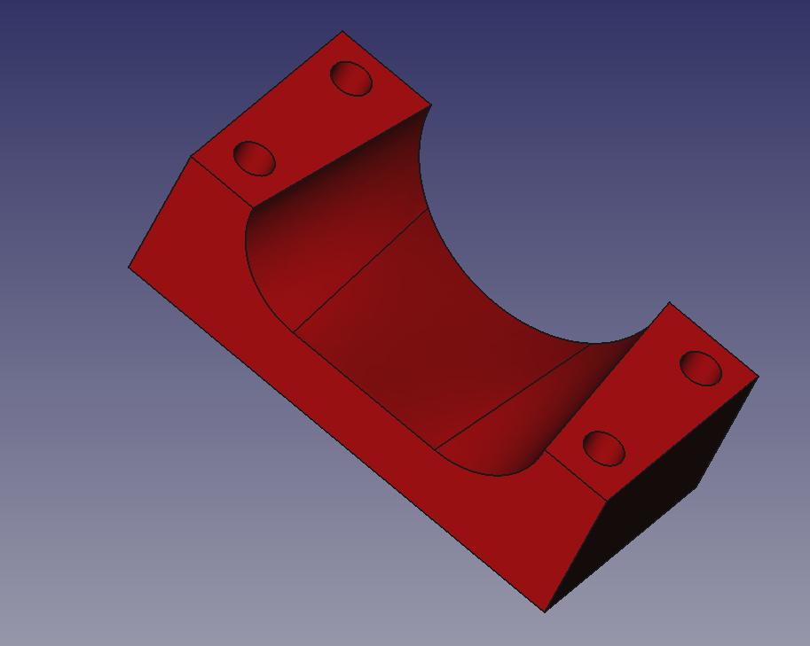

I have a little more time now.
Here is one of the first things I want to make and one of the more complex parts for the time being.
This is a forming die for aluminum tube so precision and finish are fairly flexible.
Could any of the mentioned programs do this?
It is about 100mm x 75mm x 50mm if that makes any difference.
Since I already have pycam I would love to know if it can do it?
If so then does anyone have any setup tips to minimize processing time while keeping a decent finish?
I am hoping my machine would be able to do this out of steel using a 6mm ball end cutter. I don't plan on doing much steel but I am really hoping I will be able to do the occasional small project.
So yeah if it's possible for pycam to do this I would love some suggestions on settings that others would use to do it.

I have made parts with PyCAM, MeshCAM and CamBam.
MeshCAM is the nicest, PyCAM is the cheapest. But tasks that the others can do in seconds are overnight runs with PyCAM.
CamBam is half the price of MeshCAM, and while it isn't as slick, it gets the job done. One feature I did like is that you can derive a 2D profile from the 3D geometry and use that for a 2D milling operation. This allowed me to manually create an efficient cut sequence for the part I was making.
If I used Windows or Linux as my main OS I would probably have bought CamBam by now, given the price, but I mainly use OSX. I not with some interest that some people appear to have made the Linux version of CamBam run on a Mac though. That might be fun to play with.

I can only answer with a shake of the head if you want to produce such parts with a 3 axis mill.
Do you do that for hobby, or do you want to earn money?

The thing I have noticed about pycam and freemill is that there is no good utility for driling or pocketing holes or counterbores or that kind of thing.
Do MechCAM or CamBam have any more capability in that area?
Do they have any more potential than pycam as far as tooling paths or finish?
Do any of them allow multiple operations? Like if I wanted to face the above part, then drill or pocket the holes, then switch tools and just mill the contoured pocket?
I did get Heeks running on Windows. From what I have been able to come to understand about the options discussed here or really in the sub $1000 range it does seem to offer the most potential even as limited as it is.
I need to spend some more time learning it to see what it can really do though.

I have worked at a thermoplastics composites company and we made far more complex parts on 3 axis machines with no trouble at all. I see no reason why that part would be the least bit difficult on a 3 axis.

Meshcam is a very good product at what I consider to be a pretty low cost. We use it daily and haven't found anything yet it will not do. The CAM side of things is only half of the equation however. How are you doing your CAD part of the work. Are you looking for a CAD/CAM package or just CAM? HeeksCAD and HeeksCNC are well worth looking into if you really want to stay with a Linux solution. We have not had problems with installations on Ubuntu.

It is "MeshCAM".
Both MeshCAM and CamBam have limited runtime demo versions, to you can easily download them and try them.
Both support multiple operations.
www.grzsoftware.com/download/
www.cambam.info/downloads/ or www.cambam.info/ref/ref.linux
Do any of them allow multiple operations? Like if I wanted to face the above part, then drill or pocket the holes, then switch tools and just mill the contoured pocket? .
It is "MeshCAM".
