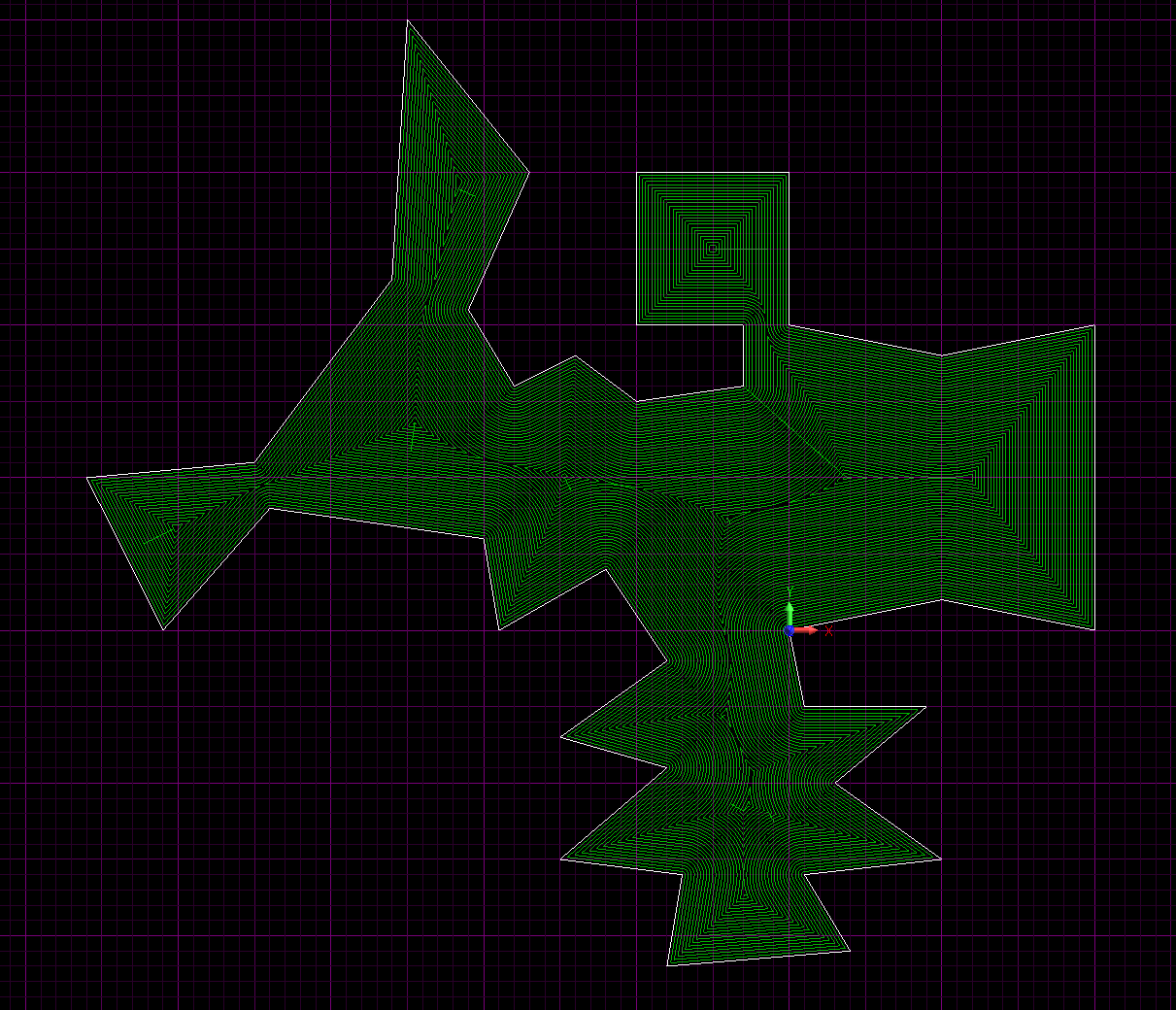

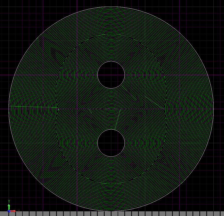

Offset toolpath with smart linking strategy, the tool will only plunge once into a contour so entry moves are possible and there are no retractions. Pockets can have multiple islands:

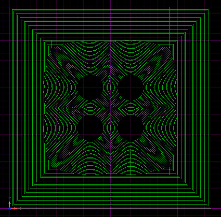

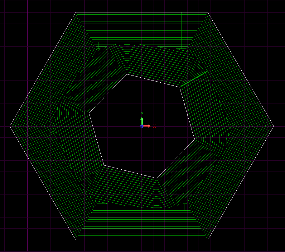

Here you can see a toolpath for restmaterial removing:

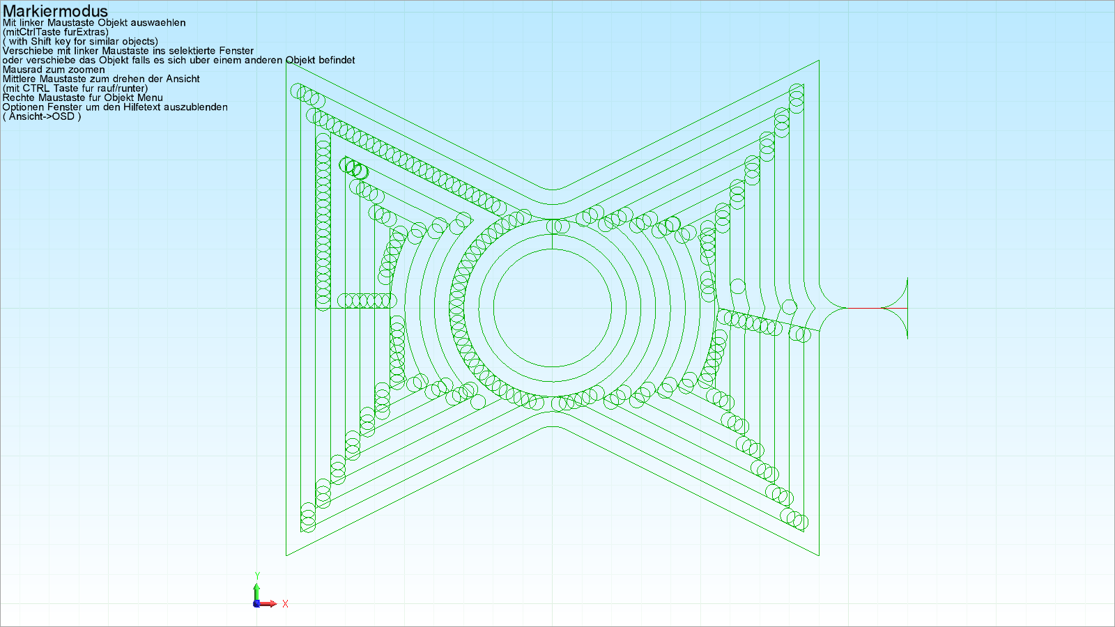

Fine miilling, here you can select between normal start and arc roll on, you can select a desired roll on within a pocket with islands. (Siemens and co can't do this)
And here you can see a optimized toolpath, my dynamic algorithm will check the whole toolpath and either place trochoids on narrow regions or slow down feed or decrease cutting depth.
