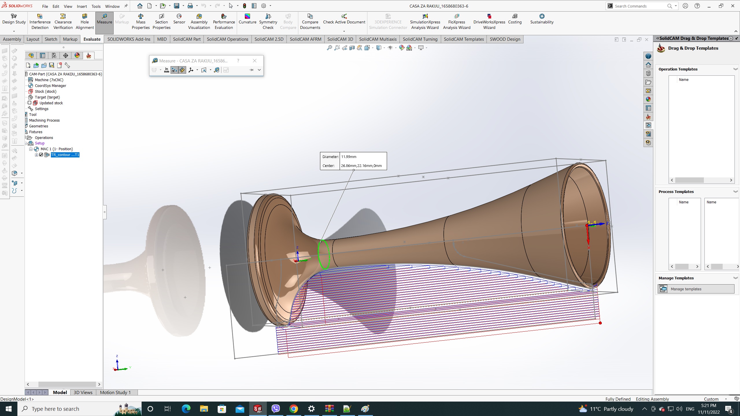

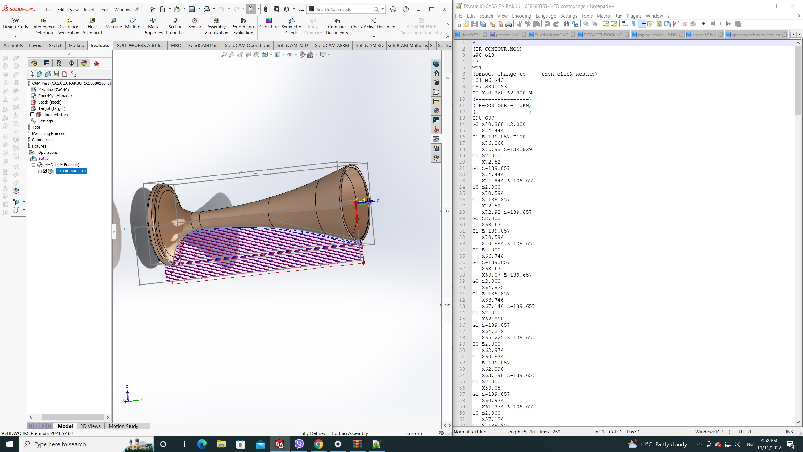

hi guys does anyone use solidcam for lathes? I use it for milling and I have no problems there. Here, I am bothered by why gcode duplicates the x coordinates, given that my ``working zero'' is in the center of rotation,model. Real model is above 50(54mm cylinder .. x should be 25mm than so it goes towards zero, or more because stock diagonals. but in the gcode it is x80+ to x12mm ( axis directions on my lathe positioned exactly like this in the picture.Thank you

You are using G7 (Lathe Diameter Mode) on you gcode, So the X coordinate is expressed in diameter of the part.

I saw that in practice it's good, just because it's my first time using a lathe it was a little strange, it's good that you told me it's G7, thanks a lot
