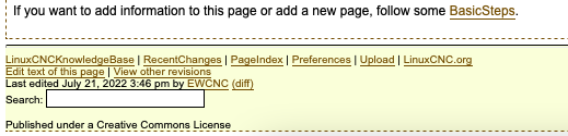

The point of the Wiki is that anyone can update it.
If you think it is out of date, then consider fixing it (it sounds like you are already collating the information)
At the bottom of the page is the edit link.
You might need to follow the "BAsic Steps" link above to see the edit link. And then you might need to know that our penguin is called Chips.

I've started updating the wiki.
Notes:
Admin password is all lowercase - does not work with a capital
Could not get editing to work in Firefox. It would accept login including admin password but no edit link on any page. Chrome works fine.
