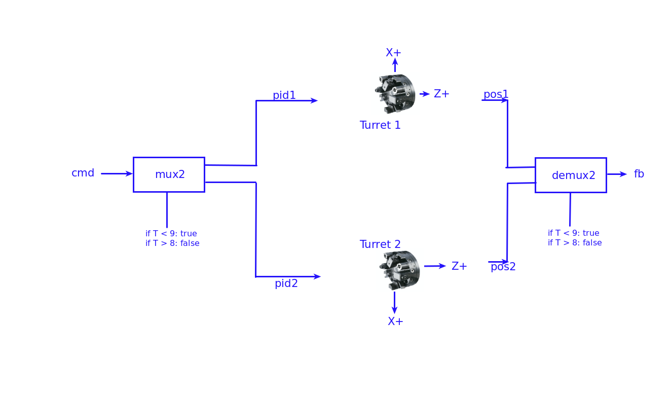

23 May 2020 16:19 #168695 by nkp
Replied by nkp on topic Re:Can Linux CNC control twin turrets?
If we need alternate work.
Is it possible to apply such a scheme?
Switch mux-demux allowed only if turret1 and turret2 in zero position.
(tool_change_position_turret1 = tool_change_position_turret2 = home_pos = (0,0))
23 May 2020 16:41 #168699 by cmorley
Replied by cmorley on topic Re:Can Linux CNC control twin turrets?
Once about a time there was an experimental branch of linuxcnc that could have two instances of linuxcnc on one machine.
The developer that did that started Machinekit, so maybe that capability got into machinekit. Then it would be a case of synchronization.
23 May 2020 16:43 #168700 by nkp
Synchronous operation is not of interest at the moment, only separate.
