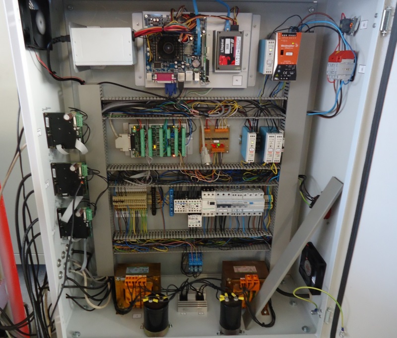

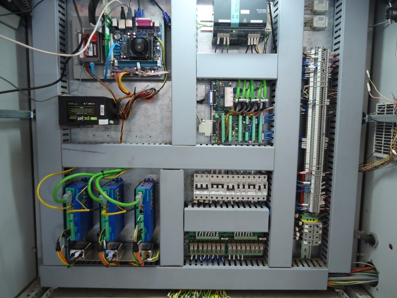

- emcPT
- Posts: 702
- Thank you received: 139
31 Jul 2014 20:06 #49343
by emcPT
Replied by emcPT on topic Control Cabinet Components & Proximities
The following user(s) said Thank You: Zahnrad Kopf
- Zahnrad Kopf
- Posts: 215
- Thank you received: 3
31 Jul 2014 20:21 #49346
by Zahnrad Kopf
Replied by Zahnrad Kopf on topic Control Cabinet Components & Proximities
Wow. Beautiful. Thank you for that. Are they yours?
