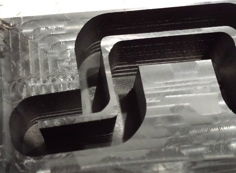

I am looking for suggestions on a problem I am having. I have a large 4'x8' gantry with two motors on the Y axis. All motors are stepper driven using G540 connected to the parallel port. I was having significant issues with the gantry racking so I've tried a bunch of things to try and nail down the source of the problem.
- I've examined the linkages on the two motors. Set screws are tight and there is no play in either.
- I've swapped drivers. What I mean by this is I have taken two other drivers (of the 4 in the G540) and substituted them in to see if it was a driver issue.
- I've changed out the external LPT card for an onboard card.
- I've changed the motherboard.
- I've changed the LPT cable so that one set of step/direction pins are now the input to both drivers. I also had to swap a phase on one of the motors to make this work.
- I've tried running at very low speeds.
- I've tried cutting air alone.
The only things I have not tried at the moment are subbing in a new power supply (48VDC 1000W), changing out the G540 and making use of some sort of breakout board which will accept the 3.3V signals from the LPT card and output at 5V so that I am not operating near the low end of the G540 input specs.
I am attaching a picture of a part which illustrates the problem.

Looks like either spindle or Z axis needs to be trammed, or you are losing steps on the Y axis.
Are you sure the gantry is racking?

The Z axis may need to be trammed (it is close) but I would think if that was the problem I'd see a very gradual progression of the offset. Here the offset is created in an instant. In this particular instance the gantry did not "rack" as it typically does with a large pop. This appears, like you say, that the y axis is losing steps. The depth of cut here was about 0.100" and the overall stock height was 0.944". So, it was ok until about the last 0.300".

A 4' x 8' gantry running steppers with a G540 and cutting metal does not seem like a good fit. Voltage = Power when talking steppers and your at 50v or less so you don't have much power. I run my plasma (54" aluminum gantry) with G203v's that can take 80v. I'm running 68v but I'm not cutting metal. I don't know what rpm your steppers are turning when you cut but as rpm increases torque decreases.
If the problem is the stair stepping seen at the bottom of the pocket you could be loosing steps from side loads while cutting. What voltage is your power supply now?

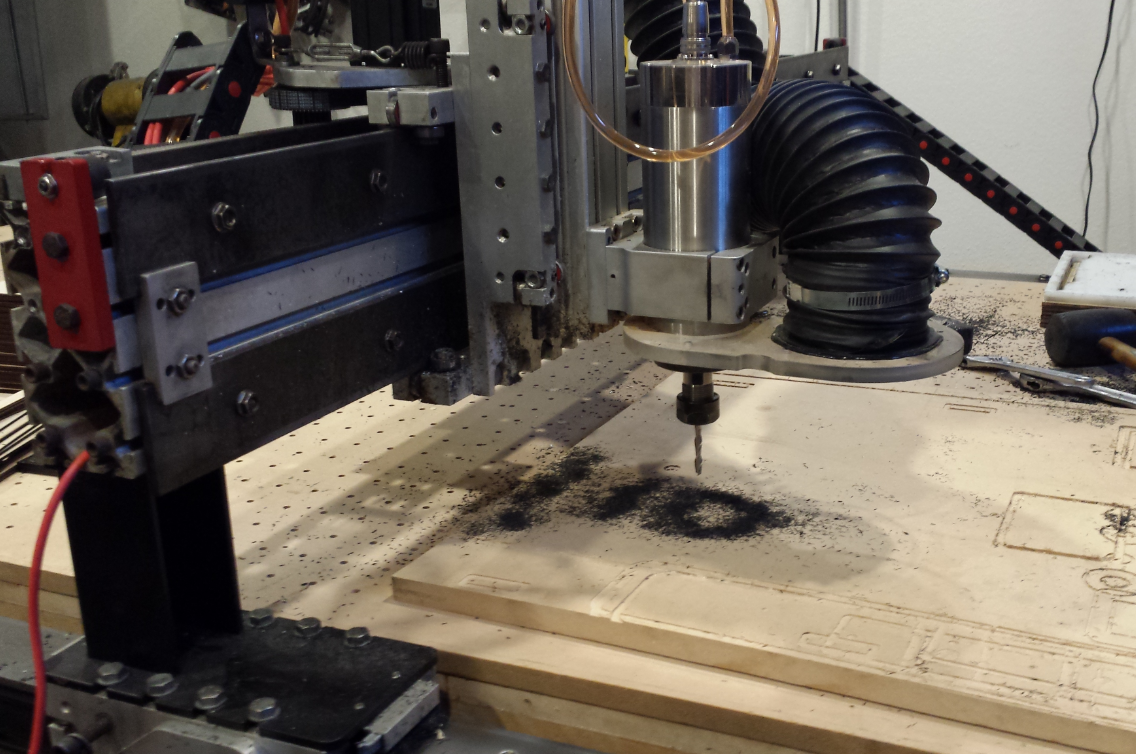

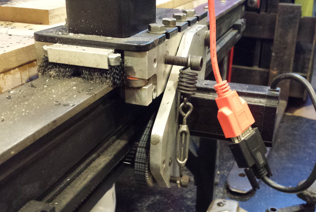

Thanks all for the responses. I am attaching a picture of the gantry as well as the linkage. The build is mostly based on the structure developed by CNC router parts.
Alan, in this particular instance I am not good about clearing the chips as it gets deep into that slot. I can't say for sure that this is not a contributing factor but I do know that the gantry racks when simply cutting air on some files. There must be particular moves which exacerbates the problem because some files are really problematic. The pen idea is a smart one and I think I'll have a go with that. I'll report back.
The material being cut here is delrin. I am running at approximately 800 SFM (0.25" diameter carbide cutter, 12,000 RPM). My feed rate is set to 30 ipm.

That looks almost identical to my machine. I have a 4x4' cncrouterparts machine.
The #1 problem people have is with the motor pulleys slipping.
as you know, the set screw is tiny, and you may not have a flat on the motor shaft for it to rest against.
I used loctite on the interface between the motor shaft and the belt pulley, then with a dab of loctite on the threads, tightened the set screw until almost rounding the hex off.
I haven't had a problem yet. If I ever need to dissassemble it, I will most likely need a gear puller, and will probably damage the belt pulley, but I can live with that, as long as it isn't slipping.
one more thing, you won't be able to see where it slipped, unless you mark it, or take it apart and see the gouges where the set screw was rubbing on the motor shaft.
They are usually tight and secure, up until they slip, change direction and get jammed up again, until it all happens again at some point.
Is your accel a little high for Y at 40? I think I run like 75 for Z, 50 for X and 25 for Y
