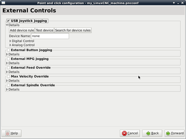

Under CNC... click Pncconfig and pretend to set up a machine... get to the part about a USB JOYSTICK and tell it to add a rule.
It will tell you to plug and unplug the device a couple of times, then say it is complete. Quit Pncconfig without saving. That just did the boring/hard part for us.

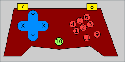

The joystick/controller I have looks like this... after some experimentation I figured out the key (button) numbers.
If you go to TERMINAL and type joy2key -terminal -buttons 1 2 3 4 5 6 7 8 9 A B C D E F G then it will map out the buttons... so if you press a button and it is #3... you will see "3" in terminal. Just make a note of all the buttons. Pressing CTRL-C will end it.
