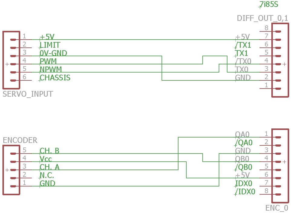

To replace a Protrak M3 controller whose driver board crapped out, I decided to go with LinuxCNC, based on information that I could find to keep using the existing servo drives to keep costs low, and talking to Mesa Electronics and this thread: forum.linuxcnc.org/forum/30-cnc-machines...ch-boards-mesa#64026
Currently I'm waiting for the 7i92 and 7i85S to arrive so I'm running a virtual machine with Debian Wheezy and LinuxCNC 2.7.2 to get used to how to configure and operate LinuxCNC before having the hardware.
I'm a little lost on how to configure LinuxCNC for the 7i92 and 7i85S though, since they are not yet supported by PCNConf Wizard.
From searching I believe I'm supposed to edit a HAL file, is there a how to on this somewhere?
The servo drives expect a 15.5kHz differential PWM signal instead of a more traditional step/direction input.
Another question I have, the servos have their own encoders, and there are also glass scales fitted on the axis as well. Should I use the glass scales in addition to the encoders for feedback and position info?

Ok, I got the boards from Mesa just before the holidays, and now I finally have some time to sit down to figure things out.
I've installed LinuxCNC Debian Wheezy on my laptop for testing, and am able to ping the 7I92 board.
That's about as far as I've gotten, I honestly have no idea how to proceed from here.
From what I've read the easiest would be to use the PNCconf utility to make a config for a 5I25 card and change the naming and addressing to the 7I92 after.
But I'm not sure how I would configure a 5I25 board with a 7I85S daugtherboard.
I've read and worked through the basic hal tutorial, and I think I understand what to use the halcmd for, but I'm not quite at that stage yet.
This is how I intend to connect the servos/encoders to the 7I85S:
I'm going to continue on by reading how to use mesaflash and maybe that will give me some insight on how to proceed.

- Posts: 18080
- Thank you received: 5316
07 Jan 2016 02:15 #68002
Replied by PCW on topic Where to start with Mesa 7i92 + 7i85S
You probably want this firmware:
7i92_7i85sx2D.bit
which you fetch from mesa and install with mesaflash
sudo apt-get install mesaflash
mesaflash --device 7i92 --write 7i92_7i85sx2D.bit (write the 7I92 flash memory with 7I85S firmware)
mesaflash --device 7i92 --reload (load the FPGA with the new firmware)
mesaflash --device 7i92 --readhmid (read out the current pinout/modules)
(I think mesaflash will use the default 192.168.1.121 IP address if not specified,
if not or if you changed the 7I92s IP address, you need to add the address to the mesaflash command line)
7i92_7i85sx2D.bit
- Posts: 19896
- Thank you received: 4648
07 Jan 2016 11:45 #68012
So, if you create a 5i25 configuration as a way to get the right file structure, you can then go through the INI and HAL files changing the pin names to suit the ones from the list. You may also need to use the "show param" command to get the HAL parameters (various settings that don't change during operation).
As PCW said, getting a bitfile to suit your application might be necessary.
There should be a listing somewhere of how the Mesa functions are mapped to the hardware pins on the 7i92. This is in dmesg with RTAI, but I don't know where it ends up with rt-preempt.
Replied by andypugh on topic Where to start with Mesa 7i92 + 7i85S
Component Pins: Owner Type Dir Value Name 9 float IN 100 hm2_7i92.0.dpll.01.timer-us 9 float IN 100 hm2_7i92.0.dpll.02.timer-us 9 float IN 100 hm2_7i92.0.dpll.03.timer-us 9 float IN 100 hm2_7i92.0.dpll.04.timer-us 9 float IN -1 hm2_7i92.0.dpll.base-freq-khz 9 u32 OUT 0x00000000 hm2_7i92.0.dpll.ddsize 9 float OUT 0 hm2_7i92.0.dpll.phase-error-us 9 u32 IN 0x00400000 hm2_7i92.0.dpll.plimit 9 u32 OUT 0x00000001 hm2_7i92.0.dpll.prescale 9 u32 IN 0x000007D0 hm2_7i92.0.dpll.time-const 9 s32 OUT 0 hm2_7i92.0.encoder.00.count ...
Time to create page: 0.308 seconds
