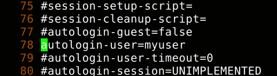

Can you tell me where I disable the password requirement so it boots with out asking?

22 Feb 2016 13:40 - 22 Feb 2016 13:42 #70477
by Amedee
Replied by Amedee on topic Struggling to install 2.7.4 debian wheezy
I am on Jessie, but to be sure I just did a default LinuxCNC/Wheezy install from the live CD.
Lightdm is indeed the default DM, so to get autologin, you just need to edit the lightdm conf file:
(or with any other text editor
And change 'autologin-user' to your username (don't forget to 'uncomment' that line)
That's it!
myuser@linuxcnc:~$ sudo vi /etc/lightdm/lightdm.confAnd change 'autologin-user' to your username (don't forget to 'uncomment' that line)
That's it!
