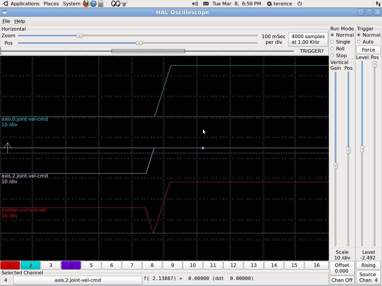

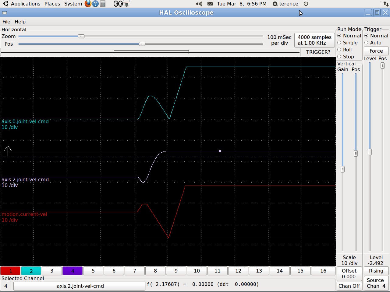

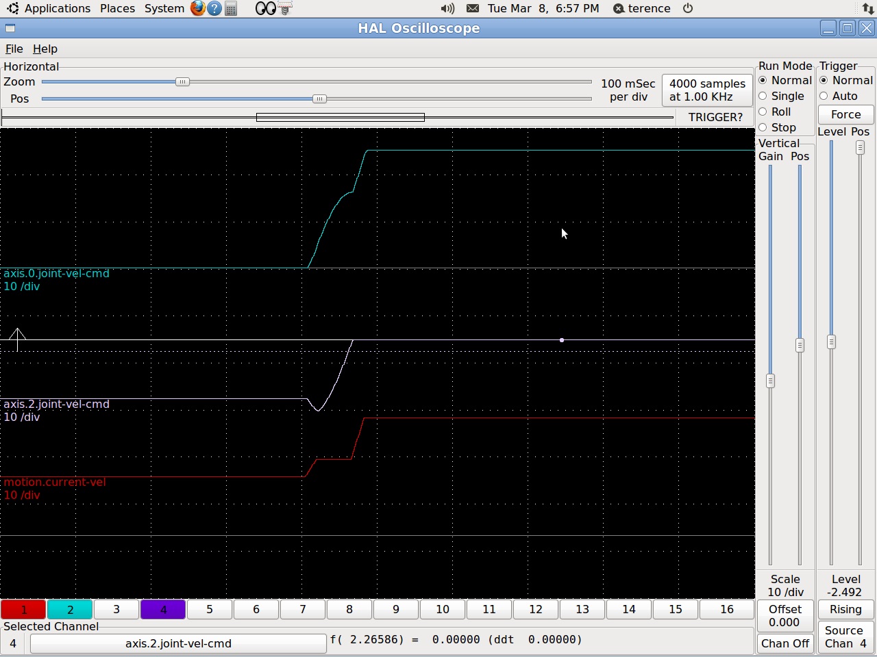

Hi! I just came across this curious thing with my 3axis CNC router. It started by noticing a jerk of the X axis (or Yaxis for that matter) happening only after a straight plunge move by the Z axis. What is curious is that it only happens with the spindle ON. I have attached a couple of Scope screenshots showing both scenarios, and also included G-code I am running to replicate the issue. Does linuxCNC plot different trajectories based on spindle state? Thank you!

No I don't have spindle encoder feedback so i shouldn't be in feed-per-rev. No spindle-at-speed either ....the jerk is also noticeable in plunges at later stages of a run, when the spindle has been long enabled.
On the otherhand, replacing G64 P0.25 by G61 produced perfectly linear motion graphs, with a complete stop at the corner...as one would expect
This time, spindle state ON/OFF does not affect the motion whatsoever.

I was having trouble getting a Halscope shot of exactly the right point in the move where the problem exits. I finally got a shot of it. Your talking about a little pause in the X axis move right after the blend of the Z to X move.
It is looking like a little bug in the trajectory planner.
If you put more moves after your first one, the pause disapears.
