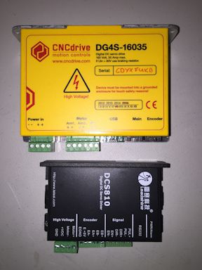

I have attached a picture of my replacement drives (Yellow) for reference and size comparison to the DCS810 drives. The software for programming these drives looks a lot more professional than the DCS810 tuning software. The replacement drives also require a external programming module that interfaces the drive to a USB port. The programming module plugs into a small 4 pin connector on the drive. My replacement drives shipped from the manufactures distributor in Florida.
I'm still in the process of building a new enclosure which attaches to the side of my milling machine and hope to have it all operational by the end of April so that I can continue with the remaining configurations to be completed in LinuxCNC.

You happen to have any working ones left you wanna offload? I figure one of these would hopefully be good enough for my Z axis at least.
While I'm sure they'd be powerfull enough, did those new drives happen to tell you what thier maximum wattage is? Every spec sheet I can seem to find only outlines the 160v / 35a...but I'm certain there is no way they can actuallly handle 5600 watts.
