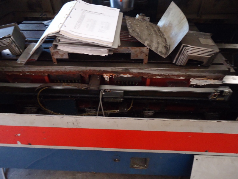

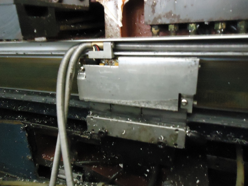

Hello.
I have a equipment with linear glass scales of type Inductosyn. I need to translate the output to quadrature so that I can use the signals with linuxcnc.
From the original set up, the board that was receiving the output from the linear scales does not have any sort of quadrature output and I believe that it feeds the controller directly with absolute position information.
The linear scale pinout is here:
Does anyone have experience with such linear scale type and know its use?
I could though away the current linear scales and place another (3 units with very hard access points) but I feel that this solution would prove to be very expensive and hard work.
Information or guidance from experience is needed.
Thank you
Thank you

Replied by PCW on topic Glass scale Inductosyn to quadrature
Is there a part number?

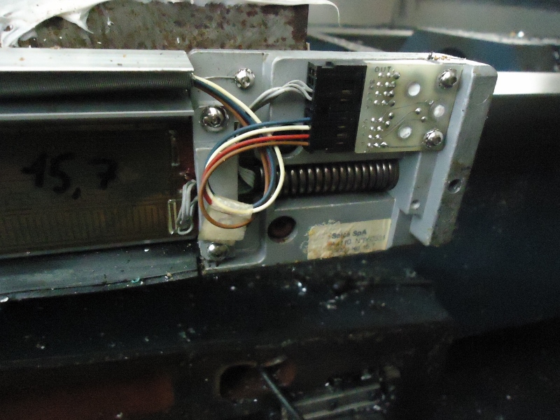

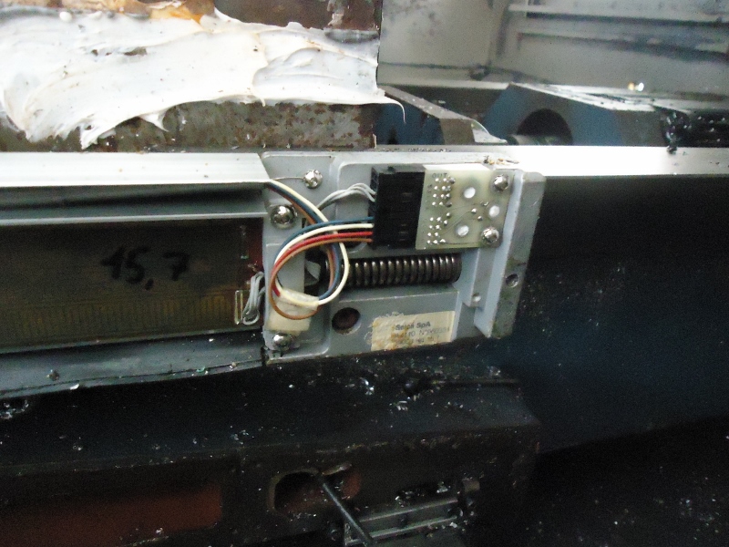

Brand: Selca (Italy)
I cannot find a part number (maybe A4110 is the only thing that does not look like a serial number).
This is probably not a glass scale as I opened the item and I can see a copper film similar to a absolute encoder, plus something like a quadrature signal (just what I wanted in the output, but not impressed on the film

I am also looking at this:
forum.linuxcnc.org/forum/49-basic-config...ed-to-close-the-loop
where most of the information says that is probably better to avoid the scales.... Maybe I am complicating to much and probably adding a high resolution encoder will suit my needs, even more that I do not even know the actual resolution of the current scales.

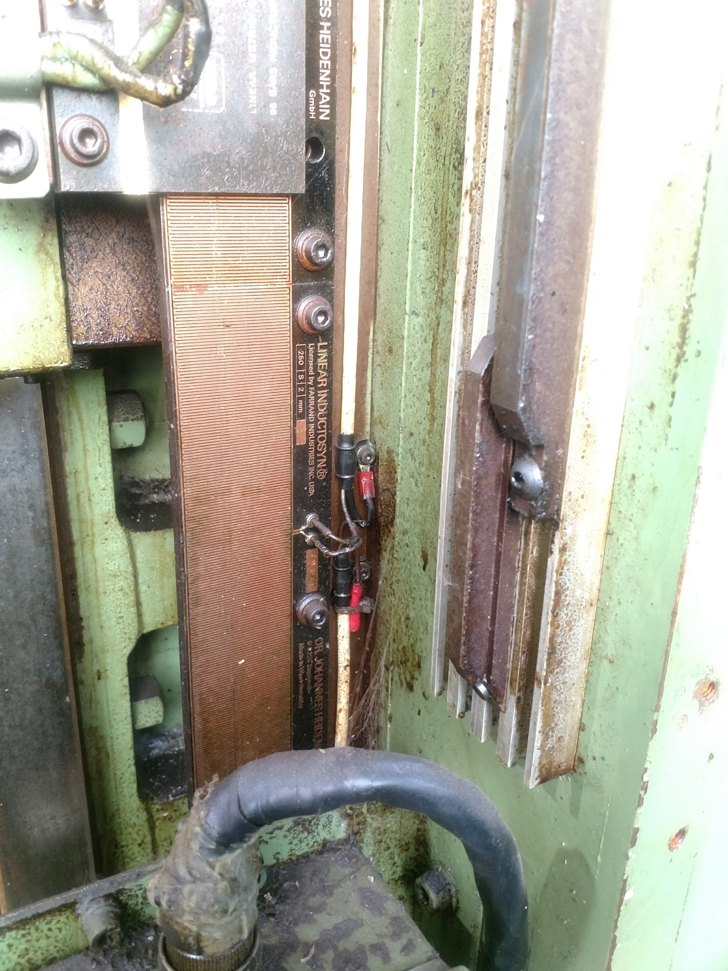

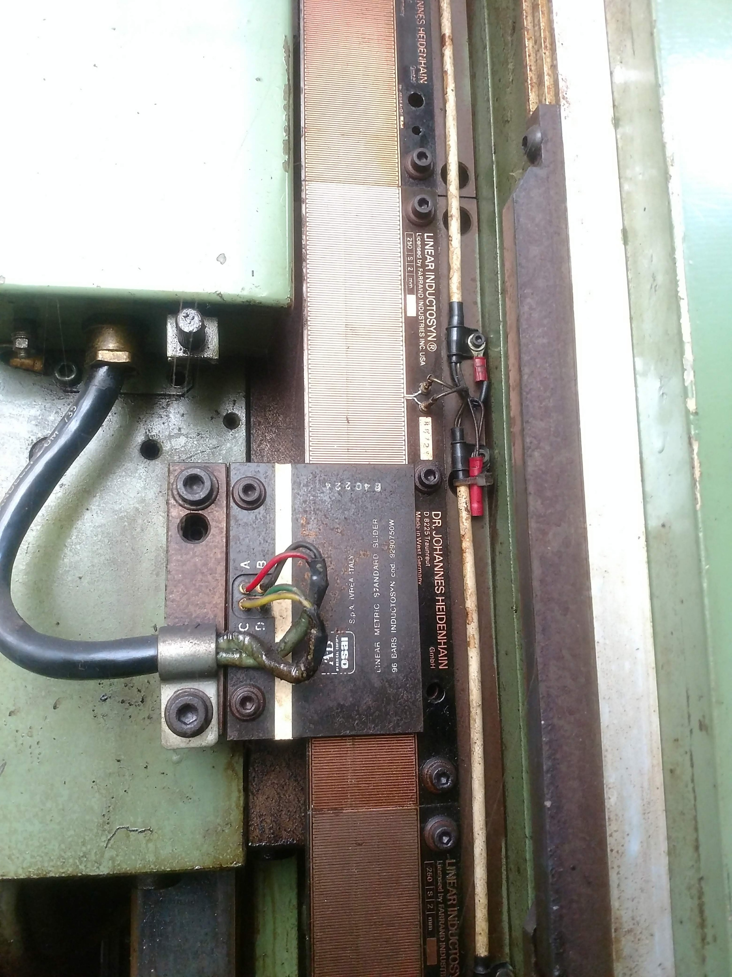

Hello,
i have a large cnc machine with Heindenhein Linear Inductosyn resolvers.
But i dont know how i can convert signals to use with Linuxcnc.
The MESA 7I49 card is suitable for these type of resolvers?

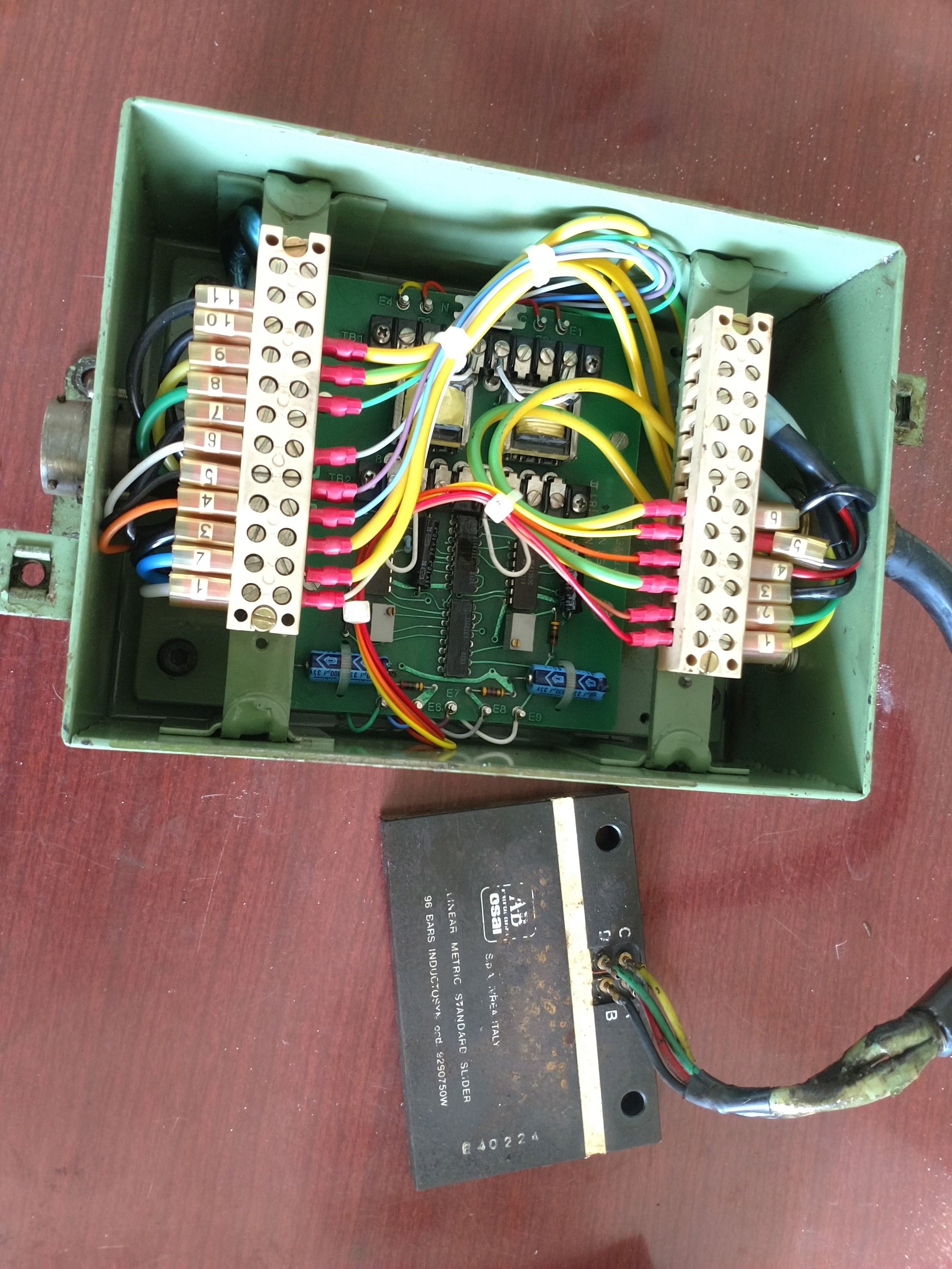

Replied by Todd Zuercher on topic Glass scale Inductosyn to quadrature
Probably should start your own new thread on this subject,
But answering a couple of questions should be helpful for those helping you..
Do you know how the old control was using them? (Is there some kind of a translator box between them and the control. That green box next to the reader head looks like a good candidate for such a device.)
Are the servo drives reading feedback from them directly? Often if the servo is reading the feed back directly from a resolver, then the drive will output a synthesized encoder signal to the control for feedback.
If the control is reading a regular resolver signal directly from those, then the Mesa 7i49 would probably be the right thing to use. If not then you probably need something else.

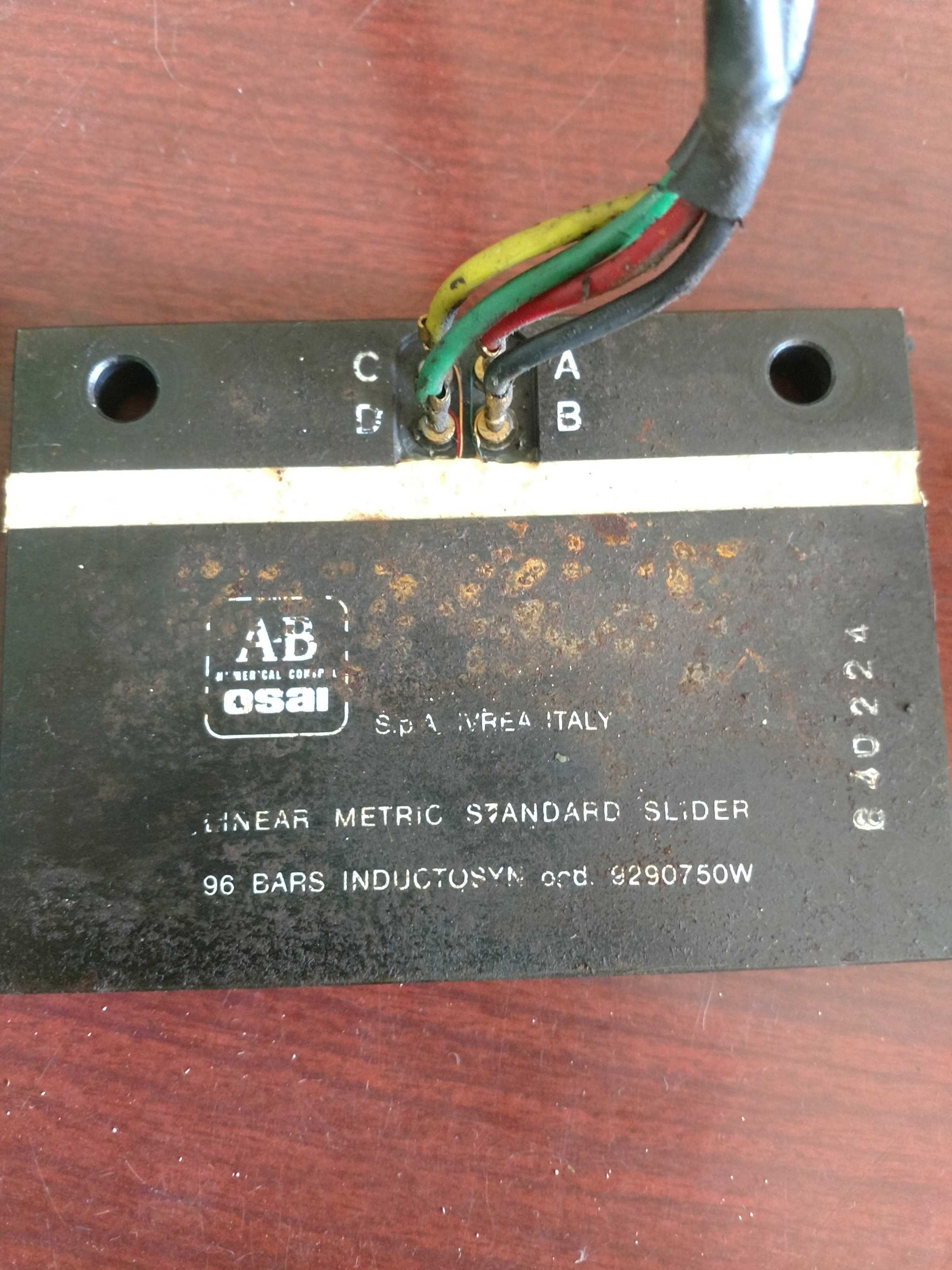

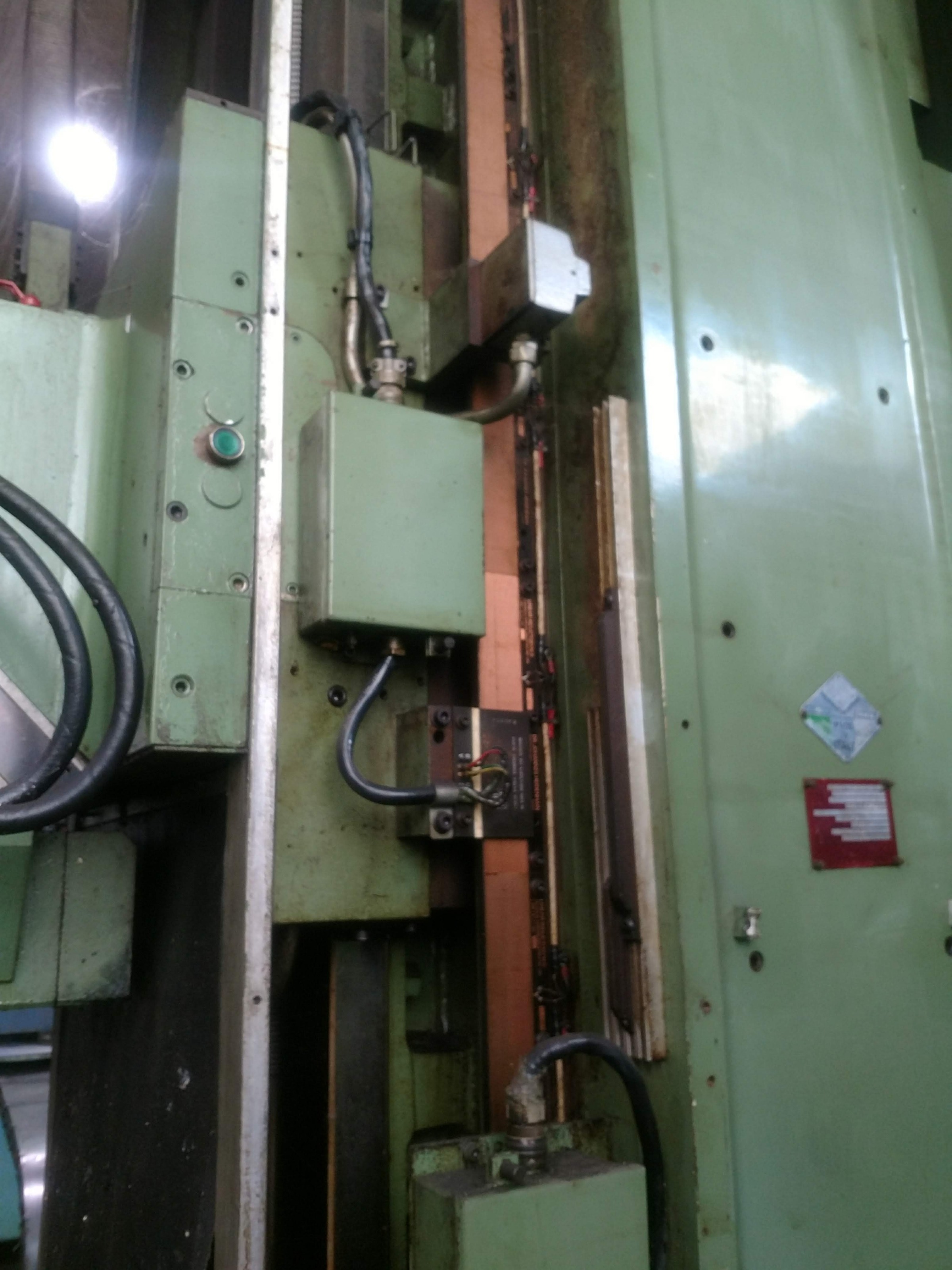

- The machine is Italian made from year 1982.
- I attach the photo of preamplifier green box. The red box is for excitation of primer coil, and in it is just a little transformer in it.
- After preamp box the resolver signals goes directly to control unit card (photo attached) and these blue signal converter units makes digital 12 bit position signals. (I don`t know how these 12 bit signals works - the scale is not absolute).
- The servo drivers are form `80-s and has no resolver input, just tachogenerator.
I don`t see similar yet. I use Heidenhein 1Vpp and 11uApp resolvers with EXE. But this is something else.
I cant find any information from reading head AB OSAI 9290750W.
