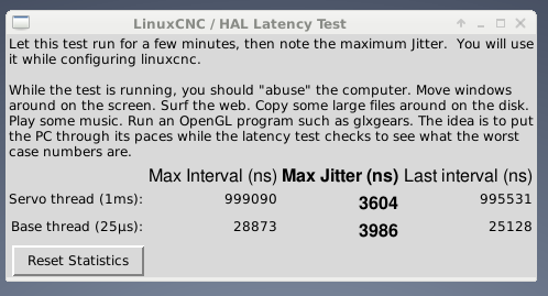

What the message states is IMHO clear, whatever the reason the realtime thread didn't get the slot when it expected to get one .. the reason for this question / post is that I can't figure out "why" it happens and "how" to solve it

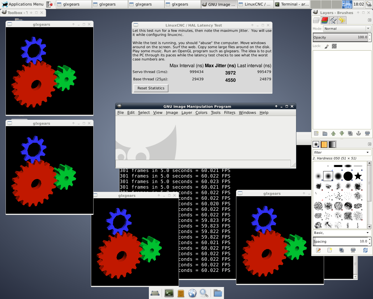

I let the latency tester run for 72 hours and I molest the machine both directly there and trough internet, I surf, search on disk, compres files, move things around, play in gimp .. for few days .. and I never seen the max jitter value touch 4000ns .. I'd say this is a good value ..
machine is dedicated for linuxcnc, some "Intel(R) Core(TM) i7-2600K CPU @ 3.40GHz" (4*2 cores) with 4G ram and "AMD HD 3600" gpu and ssd (KINGSTON SV100S264G) .. using integrated lpt port
I see in dmesg
not sure why linux switched from performance the energy stuff..
anyhow, measured jitter never touches 4000ns .. I tried using 4000 value in configurator
then I tried larger and larger numbers, finally tried
and nothing changes, I still have exactly the same problem
Not sure where to go from here ... will check if my HT is turned off, seen somewhere trying to solve the problem that hyper threading is not agreeing with linuxcnc so will kill it ..
is the linuxcnc sensitive to this things also when using mesa cards? I'm thinking of getting a mesa card (pci-e + daugterboard, will open separate thread about how to select best one but need to first get this working somehow without mesa)
