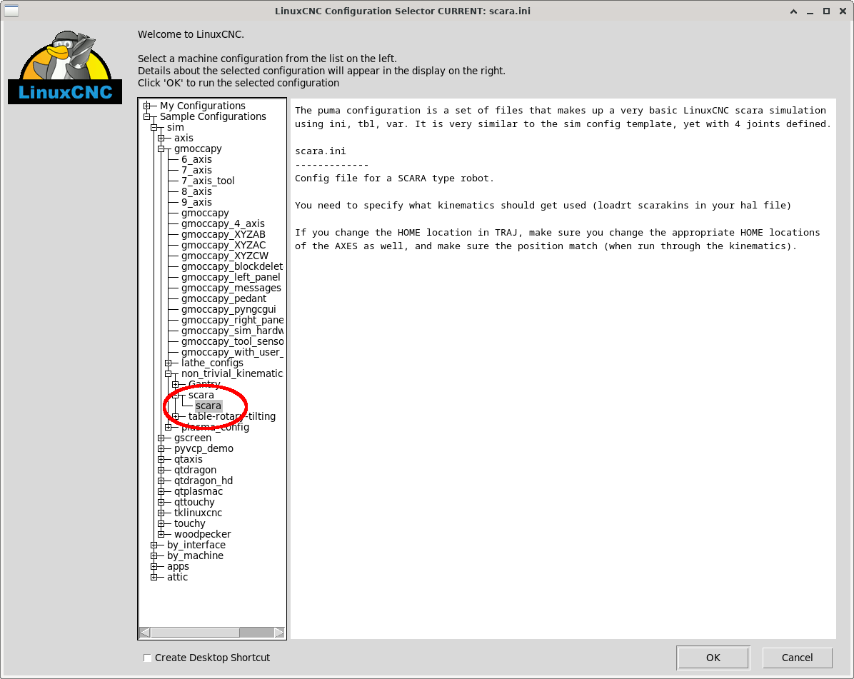

The Wiki might not be the best place to start.
You probably want to use scarakins:
linuxcnc.org/docs/2.7/html/man/man9/kins.9.html
There is a sample config to study, with a 3D model of the robot
pick sim/axis/vismach/scara/scara.ini in the config picker to see it in action.

How to program scara to draw a circle ?

The tricky part ia collecting all of the precise measurements and calibration settings that you will need to make the kinematics model work correctly.for your machine.
Replied by Todd Zuercher on topic Scara tutorial
Assuming you have set up your SCARA arm appropriately using the correct kinematics, you would program it to do a circle exactly the same way as you would program a circle for an ordinary XYZ Cartesian machine that used Trivkins. The kinematics program will automatically convert the rotary angular movement of the joints into linear XYZ Cartesian coordinates and vice versa.viski post=288949 userid=14009How to program scara to draw a circle ?
