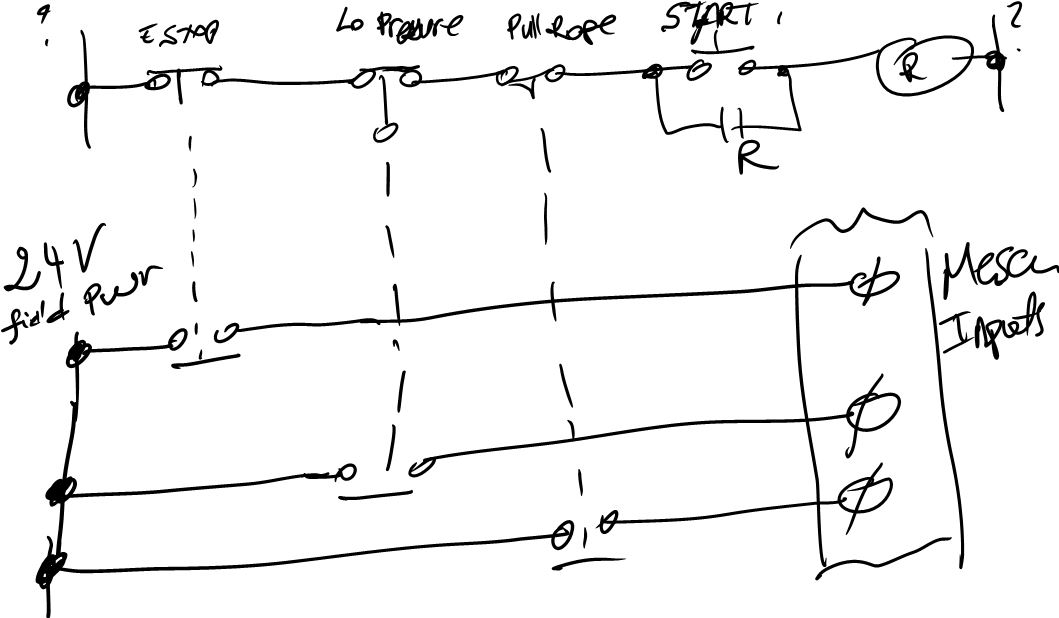

How can I inhibit turning on the machine unless certain inputs are true?
I have certain inputs that need to be true to be able to turn on the machine re: safety ropes, thermo switches, air pressure.
These are important to the machine operation and should not be able to turn on the machine if they are tripped.
Should I just put them in the e-stop chain?

OK, thanks. The machine has them all wired in parrallel through the e-stop with a latching pushbutton to start the machine and a stop button. Problem is you wont know what was tripped.
I'll try it your way Tommy. Thanks.

08 Jan 2017 04:03 #85450
by Benb
Replied by Benb on topic inhibit Machine turning on
As you have mentioned in your initial message it is good idea to wire your safety switches in series with the estop.
For annunciation and to facilitate troubleshooting wire the spare contact in the safety switches (low pressure, pulled safety rope,...) to the inputs of the mesa card and use HAL to connect the switches to your alarm on the screen.
Note: Make sure to use the field power from you mesa card to wire up the new contacts.
See attached diagram

- bevins
- Posts: 1947
- Thank you received: 338
08 Jan 2017 17:17 - 09 Jan 2017 12:39 #85479
by bevins
Replied by bevins on topic inhibit Machine turning on
So I came up with this.........
See attached wiring of the e-stop.
Last edit: 09 Jan 2017 12:39 by bevins.
- Posts: 21985
- Thank you received: 7484
08 Jan 2017 17:54 #85482
Replied by tommylight on topic inhibit Machine turning on
That looks O.K.
Does your e-stop cut power to servos, or just enable/disable them?
In case it disables the drives, your config is all good. In case it cuts the power, i would refrain from connecting anything to the e-stop loop, except the extreeme limit switches.
On bigger machines i use 2 limit switches on both sides of an axis, the inner ones wired to software limits and the outer ones wired to the e-stop loop that cuts the power to drives and almost anything else. That limits the usable work area, but it is very useful in case anything goes wrong.
- bevins
- Posts: 1947
08 Jan 2017 17:57 #85483
by bevins
The drives have two inputs, one for the limits and one for e-stop. I do not know what they do different in the two scenario's yet.
Will check that out later in the retrofit.
