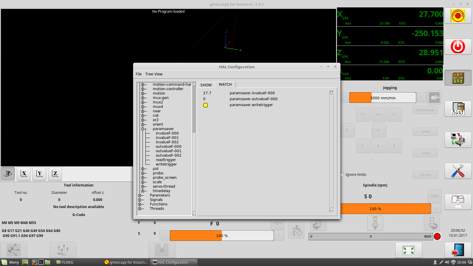

And here we have a solution that works in gmoccapy sim:
thanks a lot for the help!!!
--Per
loadrt abs names=abs_spindle_feedback,abs_motion
loadrt integ names=motion_tot
loadrt not count=1
loadrt and2 count=1
loadusr -W paramsaver f=1 s=0 b=0 filename=persist onstart=0 onexit=0
addf abs_spindle_feedback servo-thread
addf abs_motion servo-thread
addf motion_tot servo-thread
addf not.0 servo-thread
addf and2.0 servo-thread
# estop loopback
net estop-loop iocontrol.0.user-enable-out => iocontrol.0.emc-enable-in paramsaver.readtrigger and2.0.in0
net motion_in abs_motion.in <= axis.0.joint-vel-cmd
net motion_1a abs_motion.out => motion_tot.in comp_moved.in1
net motion_1b paramsaver.invalueF-000 <= motion_tot.out
net motion_2 motion_tot.min <= paramsaver.outvalueF-000
net motion_3 axis.0.amp-enable-out => not.0.in
net motion_4 not.0.out => and2.0.in1
net motion_5 and2.0.out => paramsaver.writetriggerthanks a lot for the help!!!
--Per

10 Jan 2017 19:16 #85581
by perra_e
Replied by perra_e on topic Accumulated travel distance for axes
- Todd Zuercher
- Posts: 4782
- Thank you received: 1472
10 Jan 2017 20:06 #85585
Replied by Todd Zuercher on topic Accumulated travel distance for axes
Does your persist file exist? In your vm test where was the persist file saved? Maybe the rip config can not access that location?
You might have better luck asking this question on the mailing list.
