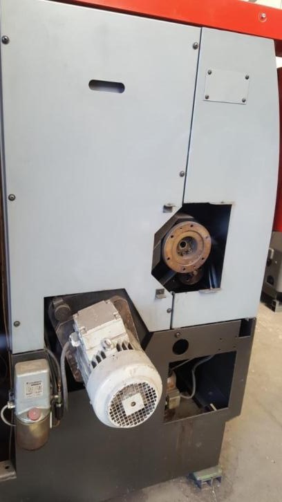

I expected there would be a 24V DC motor like the emco 120 (it has only 2 wires)
I contacted the person who came up with the toolerator3000 and he confirms the 120 only has 2 wires.
Mine has 10 (without the opto sensor board, those wires are the same). The toolerator isn't going to work for me :(
This the motor
Turret with pulley

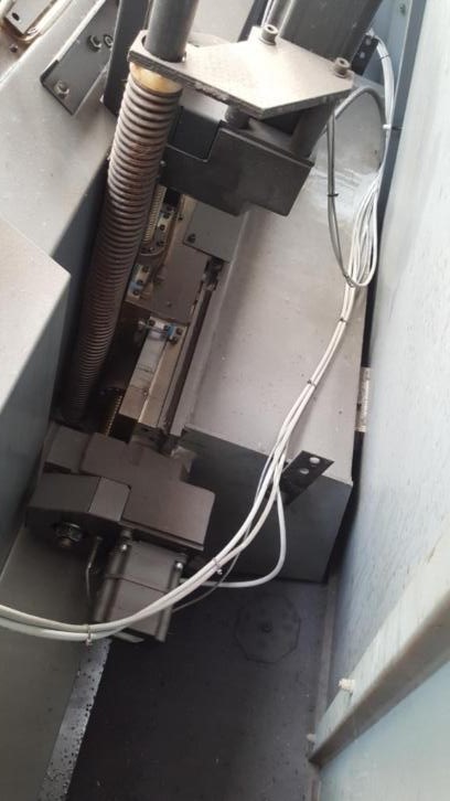

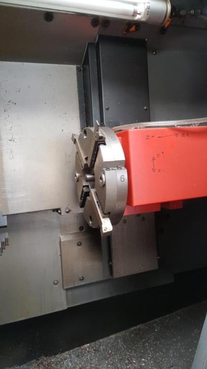

05 Jul 2017 23:30 - 06 Jul 2017 00:40 #95417 by Grotius
Replied by Grotius on topic Emco 240 Tool Turret
The emco orginal electronica is quite difficult and old from my lathe. It has a 5 pole stepper for lineair axis.
It has also a dc motor for the chuck. So for me that time when i powered on the machine for the first time in orginal condition
there was a lot of smoke comming out from the main board. So i decided to trow everythin away.
And about two day's later, it was running one a new asynchrone motor for the chuck. Also i placed 3 new stepper motors.
The only negative for me is that the turret moves a little slower then the orginal factory used motor.
Some picture's for forum readers to show how the emco cnc looks like :

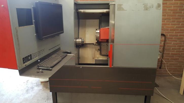

I already converted the whole machine with Nema34 steppers and a AC motor (original is DC) with a VFD. Only issue I'm facing at the moment is the turret. Nice machine you got there by the way :)
This is mine at the moment:
