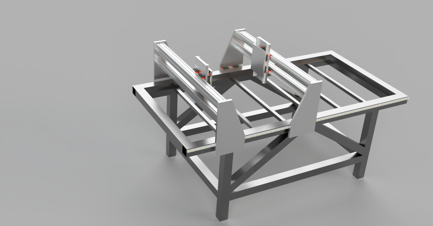

Hi I've been thinking about this for a while now a quick mockup
Not modeled the ballscrew yet and this size isn't correct but you get the idea. I cloned the gnatry on a mockup of something else I was working on.
2 gantries driven by 4 ballscrews in total 2 for each gantry so I can work it as 2 seperate machines which is how it would spend most of it's life. But would it be possible to have a shared area so they could work 1 piece? An 8 Axis router does Linuxcnc support this sort of setup?
My biggest worry of all is the gantries crashing into each other but when using them as 2 routers I can easily use different profiles in Linuxcnc (2 seperate machines, etc) so they no longer share a work area. I can see it will be hassle to wire it through switches so I can connect to 2 linuxcnc machines in one mode and 1 machine in 8 axis mode but not rocket science. The software side is a different matter.
Is this just a stupid idea.

Yes and no. Linuxcnc does support up to 9 axis (you would be using 6 (with 8 joints). The UVW axis represent parallel axis to XYZ, so it would make sense to use them for your 2ndary gantry.
Problems I can see,
1. working out how to prevent interference. (I don't think moving soft limits is currently possible)
2. The new trajectory planner only does blending and look a head for XYZ movements, it reverts to the old system for moves with any other axis.
3. Programming G-code for both would be a chore. You would need to find a CAM program that could program the code for this Siamese-twin machine.
4, Fully independent operation would require two separate Linuxcnc controls (2 computers), Making switching between independent and integrated operation difficult.
5. G-code operations are limited for the UVW axis. For example; I don't think arc movements (G2,G3) work for UVW.
For number 1 an alarm to prevent a crash during a move or a run should not be too hard, but predicting those situations when loading a g-code file like the soft limits do for an ordinary machine might be difficult.
It doesn't seem like such a good idea, when you consider that 2 separate machines would be more functional, and not cost significantly more. (The down side being needing twice as much space.)

Here is another idea of a way to configure the two parallel axis that I think might allow Linuxcnc to predict and prevent interference.
If the long axis that caries the two gantries is the Y axis and V axis. Rather than configure the V as an independent axis, set it up as the sum of the Y joints and the V joints. When set up this way a command of the Y axis would move both gantries in parallel and a command of the V axis would change the spacing between them. Set up like this I believe all of the soft limits should work. (I think)
The main downside to this set up would be possibly putting a larger and more unusual demand on your CAM software for programing independent movement of your V axis. A simple parametric find and replace of the standard V position could give you the needed command. (Could even be done on the fly with a sript when loading the file.)
For example if you wanted to move the Y axis 10 inches from 5 to 15 but have the V move -10 from 65 to 55. The parameterized g-code could look something like this.
G90G0 Y5 V[65-#5421]
G1 Y15 V[55-#5421]
parameter #5421 = the absolute potion of the Y joint including all offsets.
I am not certain what this might do to feed rates, and that could be a problem.

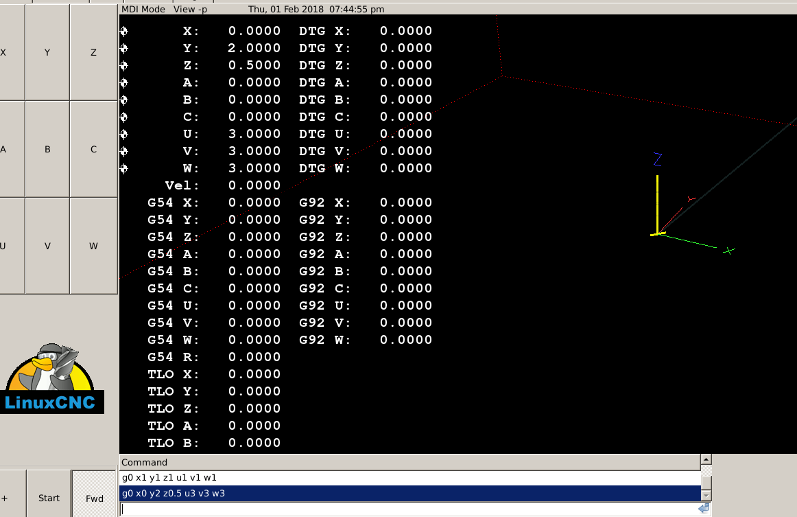

@hi Desertboy,
I think it work. I did a test with gscreen, it works.
But there is a problem when you do one line of g-code for 2 gantry's with different movement's.
You know the interpolation effects end's on the same time in one g-code line.
So that must be a seperated g-code if you want do different
things on the double portal machine.
Linux can only be started one time at the moment. Maybe if you start it two times, it will work independent.
At the moment you can only use it as a slave with one pc.

G90G93
G0X1Y1U1V[21-#5421]
G1X4U3.5981V[22.5-#5421]F0.03
Y2U4.4681V[23.0-#5421]F0.01
Y4U2.7321V[24-#5421]F0.02
X2U1V[25.0-#5421]F0.02
X1V[24.0-#5421]F0.01
Y1V[21.0-#5421]F0.03
Last edit: 02 Feb 2018 14:17 by Todd Zuercher. Reason: I really should proof read before posting.
