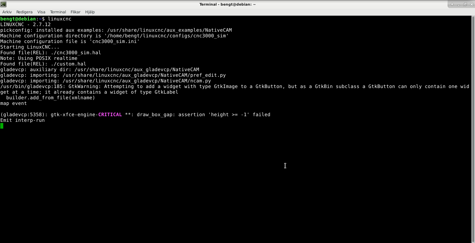

28 Feb 2018 18:30 - 28 Feb 2018 18:57 #106734
by tecno
Replied by tecno on topic Simulator
Last edit: 28 Feb 2018 18:57 by tecno.

28 Feb 2018 20:47 - 28 Feb 2018 20:48 #106755
by Grotius
Replied by Grotius on topic Simulator
@Techno,
You error has to do with a picture of a button. Can you add a picture to the button in glade? Or maybe in glade delete the button image related traceback?
Do you have a .glade file of your actual screen loaded?
For the rest your error is located in the usr ... bin... glade file, when this is happening, you can not solve this there.
So it's a quite simple problem, but has to solve in the top of the program... somewhere in glade or somewhere in your current used files.
I think you don't have to search in the python files first. I preferr to solve it in the glade file's if possible.

28 Feb 2018 21:25 - 28 Feb 2018 21:35 #106760
by Grotius
Hi Techno,
Okey thanks, the error report is for me too difficult too solve with macro instructionÅ› or command line instructionÅ›, sorry for that.
Maybe Todd can do something with teamviewer with you to solve the problem... Idea?
In your ini file i see a suspected item
EMBED_TAB_COMMAND=halcmd loadusr -Wn gladevcp gladevcp -c gladevcp -u lathehandler.py -x {XID} lathemacro.ui
Why a double "gladevcp gladevcp"?
My logic tab line idea would be :
EMBED_TAB_COMMAND=halcmd loadusr -Wn gladevcp -c gladevcp -u lathehandler.py -x {XID} lathemacro.ui
This is logic without looking ad the meaning of the code that is written... Double loading makeÅ› most of time no sense.
