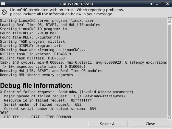

Axis errors out when ran from an RDP session

Replied by tommylight on topic Axis errors out when ran from an RDP session
Well that "bad window" should explain it, it can not make a window to display the content as it is software emulated, and i am fairly certain that there is no way of running GL apps over RDP.
There is a nice way of running it over SSH that works nicely, so search for it or Andy can mention how if he reads this.

- stioc
- Posts: 21
25 Apr 2018 21:47 - 25 Apr 2018 21:48 #109614
by stioc
Replied by stioc on topic Axis errors out when ran from an RDP session
Oh ok, I didn't know it won't run on a remote session like that. SSH would work if you're on a system that runs an X Server. I'll try VNC and see if that works, if not I'll install an X server on my windows box. Thanks.

25 Apr 2018 22:25 #109617
VNC does work but lags a lot, so not really usable.

01 May 2018 23:07 #109964
Replied by andypugh on topic Axis errors out when ran from an RDP session
I use SSH. I seem to need to use the -Y flag to make it work.

- stioc
- Posts: 21
02 May 2018 16:22 #110035
by stioc
Yes the -Y just bypasses the security restrictions of X11 but on a windows computer you need an X server. I haven't gotten around to it yet as there are other things taking priority but I'll update once I have it working.
- stioc
- Posts: 21
03 May 2018 00:21 - 03 May 2018 00:38 #110078
by stioc
Resolved. I had a few mins this afternoon to install MobaXterm on my Windows 10 desktop and got it working, you need to have Putty installed that MobaXterm uses for X11 over SSH. Works great! Now if I can just teach the dog to go chuck up the stock I can monitor and run the mill from my desk
