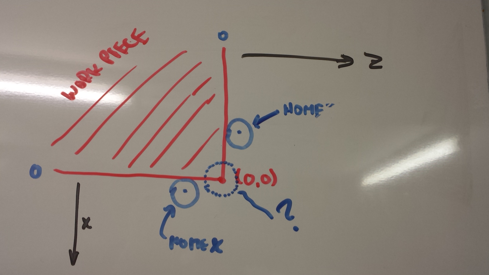

I wrote 2 days worth of gcode for my lathe.
Tool is 3mm half round and cuts both sides and on the round front.
The code was written to use cutter compensation for 3mm diameter.
It works.
So PROBLEM:
How do I home the axis with the tool in place?
Code is designed for 0,0 to be at right front corner of the workpiece but without compensation so centre of my tool must be at that corner.
How do I work around this hurdle?
Add offsets in the code everywhere?
Is there an easier way at all?
Any help is greatly appreciated.

Attached is a picture of what I want to do and where my 0.0 needs to be relative to the tool.
Can anyone shed light on this mystery?
Regards
Bernt

- Clive S
- Posts: 2204
- Thank you received: 486
07 Sep 2018 09:07 #117177
by Clive S
Replied by Clive S on topic Homing to sides of workpiece with real tool How? Lathe
How about posting a screen shot also which boxes are you entering the data in?
The home position can be anyware you like it does not have to be at the edge of the stock and I believe that is G53. Then when you touch off it become generally G54
which version of Lcnc are you using
linuxcnc.org/docs/2.7/html/lathe/lathe-user.html
- verticalperformance
- Posts: 55
- Thank you received: 11
07 Sep 2018 11:56 #117179
by verticalperformance
Replied by verticalperformance on topic Homing to sides of workpiece with real tool How? Lathe
How I do it.
Home the machine - as I have no home switches I generally move the x axis z axis to mid travel and home there. (with x being approx=0 = the spindle axis)
Mount the tool you wish to use.
Using the MDI window, enable that tool with a Tx M6 where x is the tool number.
Take a small test cut by manually jogging the machine in x to get a small cut and then jogging in Z, Jog back out in z leaving x unchanged and measure the resulting diameter
touch off the x axis (not tool touch off) and in the input box enter half the measured diameter (assuming you are in radius mode rather than diameter mode)
The on screen coordinates for radius/diameter should now reflect the measured diameter too as a check.
Having tool offsets in the tool table is only of value if you can change tools with the new tool being loaded in a known location - eg by using a quick change tool holder with a separate holder for each tool, or by having some kind of touch off switch that can measure tool offsets on the fly.
- berntd
- Posts: 41
08 Sep 2018 09:55 - 08 Sep 2018 10:01 #117215
by berntd
Replied by berntd on topic Homing to sides of workpiece with real tool How? Lathe
Another day of struggle...
I can only use it as follows: Not ideal.
3mm half round tool as earlier.
1) move X in until it touches OD of blank.
2) Home X.
3) remove workpiece.
4) Move X in by 1.5mm on CNC coordinates.
5) Home X again.
6) Workpiece fitted.
7)Move Z left until tool touches face of workpiece.
8) Home Z
9) remove workpieve
10) move Z left 1.50..
12) Home Z again.
Done.
So now the tool centre will sit on 0,0 is on the worpiece corner.
When putting the yool on 0,0, it's centre would align with the worpiece corner. But of course it can't move there as the worpiece is in the way
Surely this must be possible to set with the touch of or offsets somehow?
I have not managed so far.
2) Home X.
5) Home X again.
8) Home Z
9) remove workpieve
12) Home Z again.
Done.
Last edit: 08 Sep 2018 10:01 by berntd.
- OT-CNC
- Posts: 617
- Thank you received: 75
08 Sep 2018 15:56 #117222
by OT-CNC
Replied by OT-CNC on topic Homing to sides of workpiece with real tool How? Lathe
I assume you have looked over the Lathe documentation. The control point section is helpful.
linuxcnc.org/docs/html/lathe/lathe-user.html
Also, machine home is different from part zero and you are not homing the machine to the part. I think there is some confusion there. Usually machine home is away from the chuck.
You also need to load the tool offset by issuing a G43.
T1 M6
G43
T1 M6
G43
