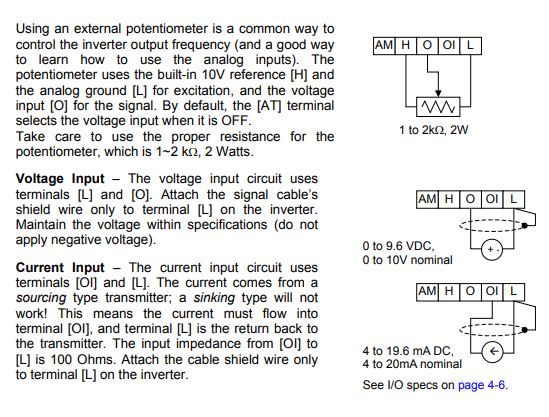

This is from the manual. I'm using the middle scenario - "voltage input", correct? I'll have to test for voltage on O this evening, but I suspect it's there and I'm back to just missing a parameter in the VFD itself.
When I got it, he did have a wire connected to "H" as well. I'm 99% sure that it was not connected to anything on the 7i77 and was likely just left over from a different setup when he initially was wiring it.....but there's that 1% chance that I missed something between replacing the drive and the 7i77.

Well, that was somewhat easy.
I verified that there was varying voltage between L and O.
Then I re-read the quick reference manual on the "Run" light. As it turns out, that light should only be on when it's actually "armed" and ready to run. The A002 parameter wasn't set properly for an external command. It was waiting for me to physically press the "Run" button instead of using the signal from the 7i77. At some point I had tried it on 02...probably when I had the other wires backwards.
I changed it to 01 and the spindle spins up as expected now.
Now hopefully the first WJ200 burning up was just a fluke and there's not another underlying problem.
