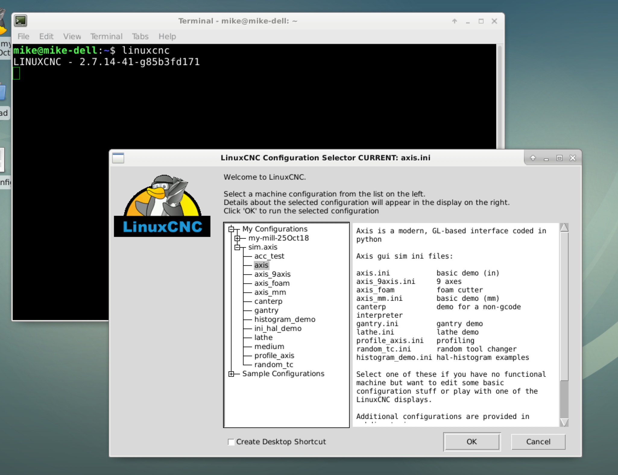

Is the directory that has your INI file (~/linuxcnc/my-mill-25Oct18/) ?
type this in the command line:
Then post the errors listed in the terminal.
cd ~/linuxcnc/my-mill-25Oct18/
linuxcnc my-mill-25Oct18.iniThen post the errors listed in the terminal.

mike@mike-dell:~/linuxcnc/configs/my-mill-25Oct18$ linuxcnc my-mill-25Oct18.ini
LINUXCNC - 2.7.14-41-g85b3fd171
Machine configuration directory is '/home/mike/linuxcnc/configs/my-mill-25Oct18'
Machine configuration file is 'my-mill-25Oct18.ini'
Starting LinuxCNC...
Found file(REL): ./my-mill-25Oct18.hal
