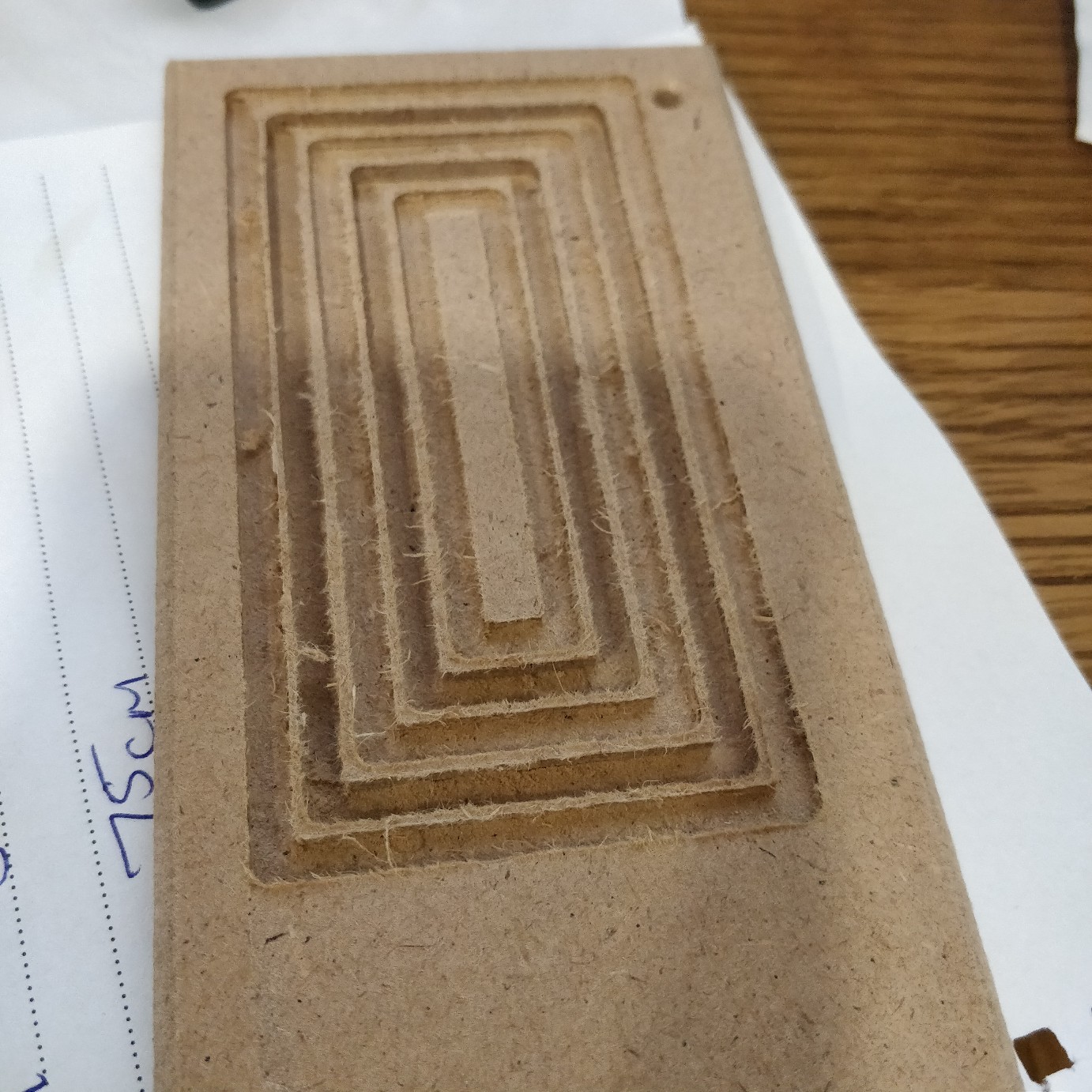

I made the following concentric rectangles earlier and used a 3mm End Mill on them.
I ran two different tool paths (albeit using the same tool) and they came out (in my untrained eye) excellently.

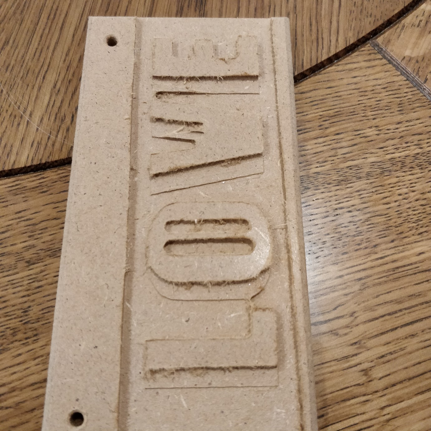

I then made a small sign up (these blanks are only 150mm x 70mm).

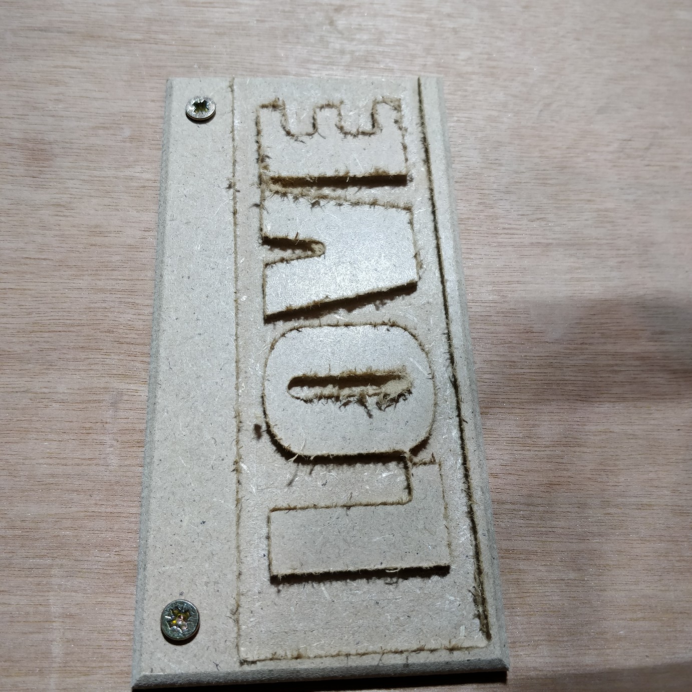

I set up two toolpaths. One using a 3mm End Mill again which created this.....
And then another running after this one using a 2mm Ball Nose. It might be worth noting that there wasn't a 2mm Ball Nose in the software so I added it with the following parameters (I am clueless at the moment regarding feed rates etc as I'm completely new to CNC but I took most of the settings from the 3mm Ball Nose and just lowered them slightly).
After running the 2mm Ball Nose it messed the carving up...
You can see in that last image it is as though the whole thing has moved over to the right?

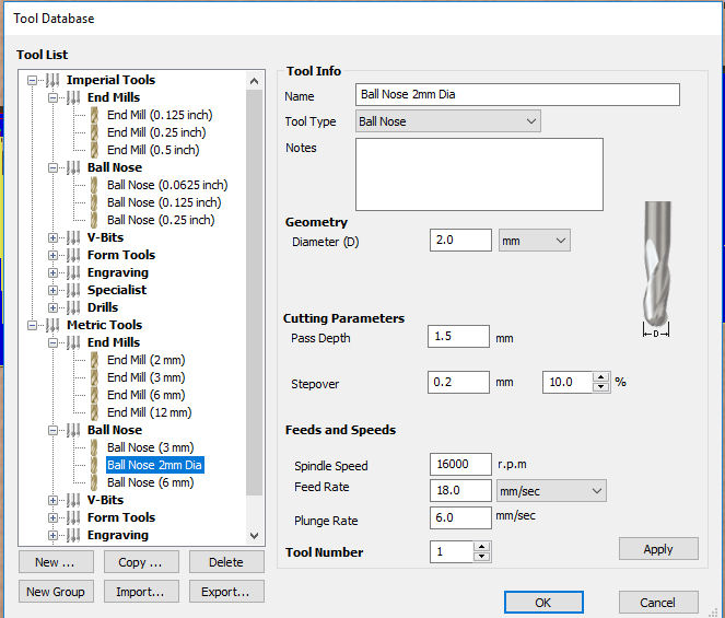

That's a good point Andy? I'm not sure. I'm using Aspire and I've looked in the Tool menu and can't find anything to do with an offset?
Do you know where that setting would be? I'm brand new to Aspire so still finding my way around the software and working through the YouTube tutorials.

The tool offsets are saved in the tool table of Linuxcnc, but that shouldn't have been your problem because the g-code files are using the same tool offsets (unless you changed them between runs. (You didn't do any touch off or tool touch off between runs did you?) If you did a touch off of some kind between runs, a mistake there could have caused it.
The files look to be in the same positions.
You changed tools between runs, Did you have the motors disabled while you were changing tools? If you did, you could have easily moved the machine's position while wrenching on the spindle to change tools.
There is still the possibility of a mechanical issue, a slipping coupling, lost steps, or you forced the spindle to move while changing tools.

That's great info Todd. The motors were definitely locked when I changed tools and nothing moved at all. I didn't touch off etc between tool changes.
It must be losing steps somehow. I wondered about electrical noise. When I get back from holiday I might try and set up a simple carving of a series of holes and try and keep repeating them to see what happens.
