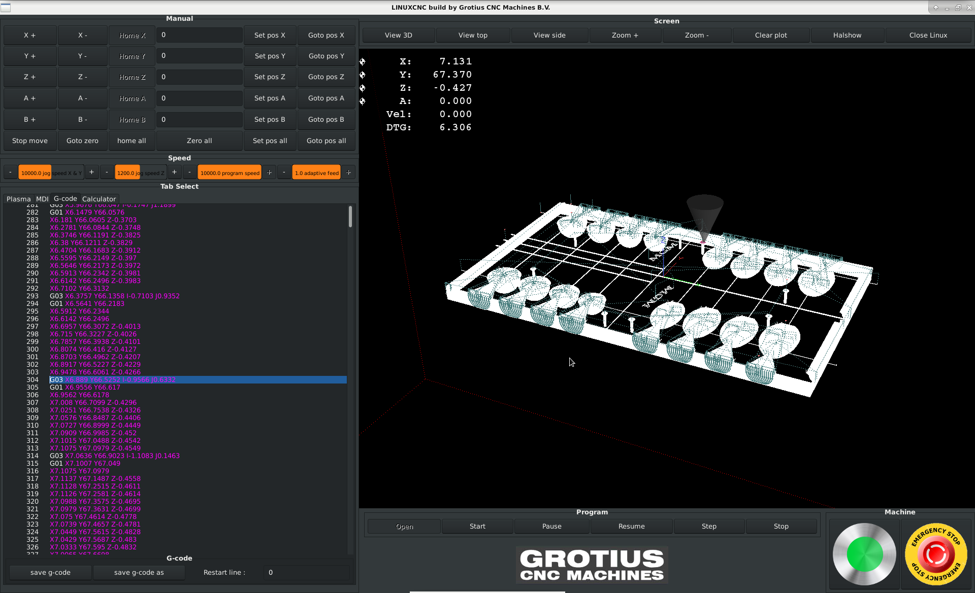

Hello,
Don't know if is only my linuxcnc or is a defect.
My linuxcnc (2.7.14) after running big programs and with may hours of gcode gets very slow (only the linuxcnc interface)... if i try to do joging it don't respond instantly and when releasing key jog the machine continues moving some seconds if i do start again the machine runs normaly but all visual things of linuxcnc is very slow..... if i close linuxcnc and start it again it's normal again.
my normal programs are like this: marcogaspar.net/linuxcnc/10_01.zip about 14h running
i atached my config files.

If linuxcnc start's, what kind of warnings are diplayed in terminal display?
If you don't get warning's at startup, i don't suggest any buffer's that would be come overloaded.
Another suggestion is, try the same program with a fresh pc and concider the differcence in output level.
Do you have goto statement's in your code?

I suspect there is a tad to little memory in the machine. How much is there?

Haha 3.7 milion lines of gcode.
Hmm, small piece 100mm. 18000 spindle speed. Looks like a difficult part, hard surface.
Still not loading. Tool 3 not found, If i add tool 3, no loading.

My suspicion would be that this is backplot related
Do you need the backplot?
Have you checked the behaviour with the backplot disabled or limited?
Running top might give some more insight into where all your CPU cycles are going...

No i do not need backplot.
How to disable or limit it?

You can turn off the backplot by hand via the GUI (in axis these options are in the view menu)
You can also disable the preview with a gcode comment (AXIS,hide)
