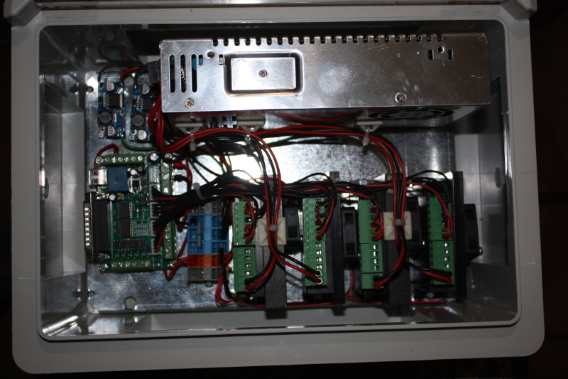

it simply depends on your need if you want to go that way
a Good Standard Setup on a "leadshine D556" will get you in the same Precision,Speed and torque as the Hybrid
with less then 1/3 the Cost and on Lower Hardware Electronic and Power consumption
Standard 36V 15A
2x lm2596 for 12/5V
