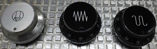

- MaHa
- Posts: 540
- Thank you received: 240
08 Mar 2019 09:19 - 08 Mar 2019 10:50 #128068
by MaHa
Replied by MaHa on topic MPG handwheel sources
Last edit: 08 Mar 2019 10:50 by MaHa. Reason: jpg size

08 Mar 2019 15:19 #128081
by OT-CNC
Replied by OT-CNC on topic MPG handwheel sources
These all look similar to the ones I use off fleabay. I wore out the spring detent mechanism pretty quickly on one. There is a rather thin stainless flat spring that pushes against a roller that clicks into the grooves. Mine fatigued and snapped. I replaced it with a home made spring. Works fine but the feel is a bit loose now after some time. Also the lines engraved on the dial do not always line up with the slot, suggesting it was not concentric during marking and the timing is often off too. The lines may line up in the vertical position and half rotation between two. If you're like me and that kind of stuff bugs you, I suggest getting a better unit otherwise they are just fine. Once installed you most likely never look at the dial and the lines anyway. The tactile feel to me is more important.
MaHa
Nice job on the engraving. I did mine on the laser. Looks cool.
MaHa
