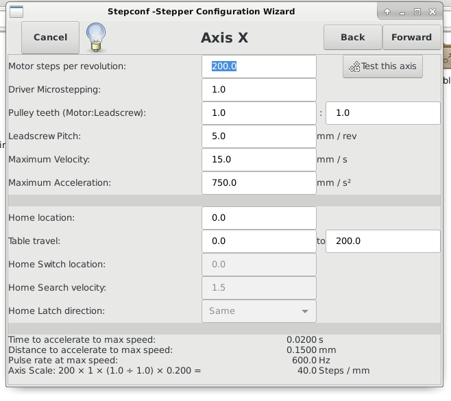

Right now I'm about to create a new step configuration for my machine. For this machine, the X and Y axis will be controlled using nema 17 stepper motor and timing pulley GT2. What I want to ask is, what should I put in the "Lead Screw Pitch" column for the stepconf?
Last edit: 7 years 6 months ago by richard123.
7 years 6 months ago #131248 by Clive S
Exactly what it states . what it means is if you rotate the screw one revolution how far would the axis (table) move. So in the example it shows 5mm/rev. that means the axis will move 5mm for one rev.
If you are using screwed rod as a lead screw say 10mm it could be 1.25mm pitch (ie one rev would be 1.25mm travel)

Clive s wrote: If you are using screwed rod as a lead screw say 10mm it could be 1.25mm pitch (ie one rev would be 1.25mm travel)
10mm or M10 would be 1.5mm
M8 is 1.25mm

Yes but that is not what the op wanted to do. He was asking what numbers to put in stepconf
