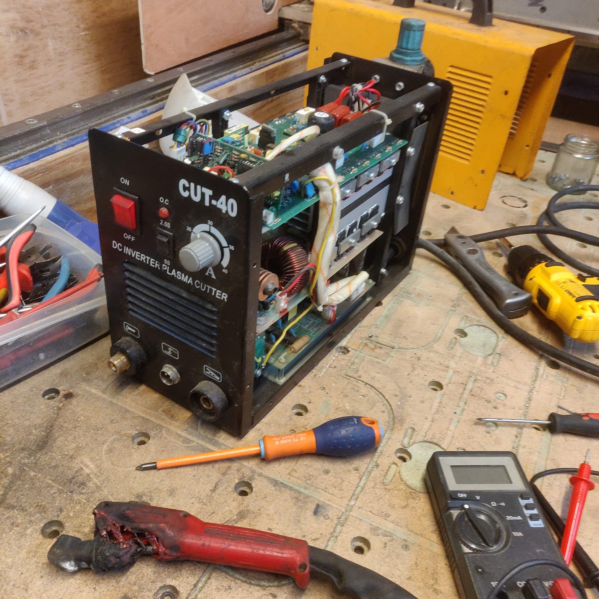

Before I order a mesa THC which version (0-10v or 0-300V) will I need for an old simple cut 40 machine
And is it possible to use this machine? With a new torch :laugh:

03 Jun 2019 09:24 #135722 by Clive S
Replied by Clive S on topic ABOUT THC
300V version
Thanks: I am sure you once mentioned how to get the source of the signal out of the machine could you please point me to that.
03 Jun 2019 10:33 - 03 Jun 2019 10:33 #135731 by rodw
Replied by rodw on topic ABOUT THC
I can't see why you want to waste money on a new torch!
Just mount the THCAD300 inside the case, power it from 5 volts from your control box.
Alternatively, use the THCAD-10 and mount it in a metal case on the outside and put the necessary resistors 50:50 in wires from the electrodes. There was quote a discussion on this on the plasmac thread recently as both Phill and JTKnives have Hypertherm 30 amp machines with no CNC port.
Pretty sure thats a HF start machine so you will really need to pay attention to grounding. Separate wires back from every motor to a central star ground point on the machine and attach it to a ground stake. Also use an IEC mains power connector with built in EMI filter for your control box power.

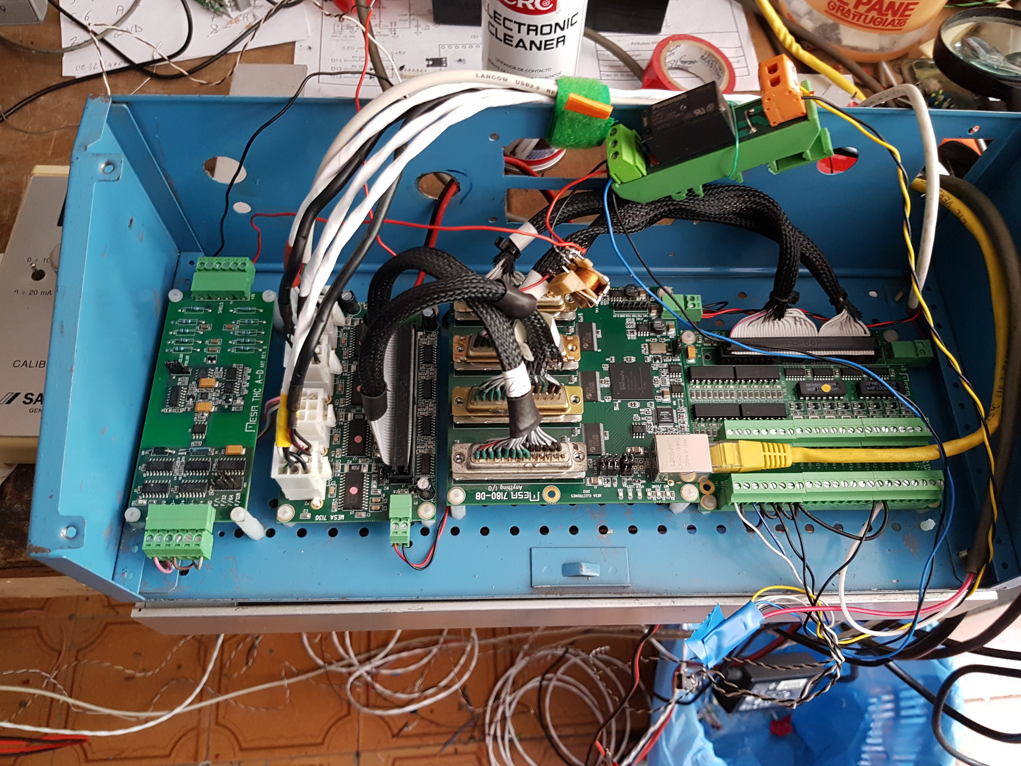

03 Jun 2019 11:02 #135733 by billykid
Replied by billykid on topic ABOUT THC
yes this is a plasma hf and I would use 10, it seems to me that the mesa on hf machines recommends external resistors.
my plasma does not have hf, I have the thcad10 in this box where before I had an analogue thc made by me, never had disturbances, the output of the external divider is very similar I should have no problems, what do you say Rod?
03 Jun 2019 11:21 #135735 by Clive S
I thought about repairing it B) but decide to get a new one £15 from China. I acquired the cut 40 for free.
I am now confused re the 300 or 10 . Also why the 300 inside the case and the 10 on the outside !! I will try and find the post you are referring to.
Re the grounds: Yes although this is my first Plasma I have built several routers and conversions all with Mesa stuff .

@Billy, my THCAD-10 is in my control box and that has never been an issue with a blow back torch.
From what I can understand is that in a HF environment, keeping the THCAD close to the plasma reduces the chance of EMI as the frequency output is more immune than a simple divided (low) voltage signal.
At one stage, I purchased a cheap USB Oscilloscope which gave some interesting insights into noise. Most of it seemed to be coming in via the mains power. This was the single most effective noise reduction measure I implemented.
