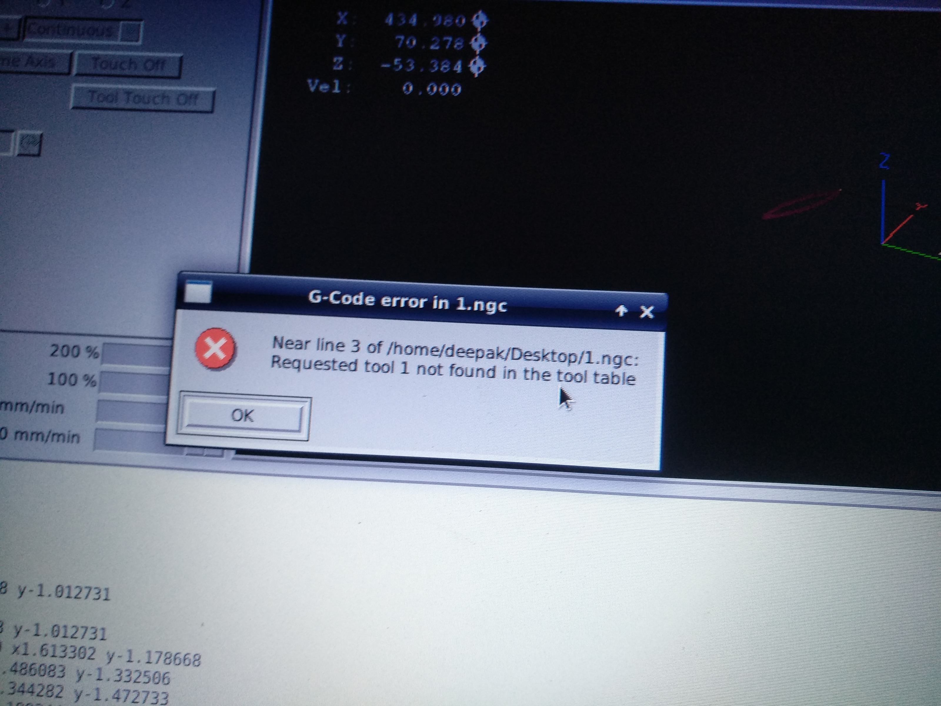

I am trying to set up thc toma on my plasma machine..
Any tips would be appreciated
When i jog machine is jogging but my cone shaped pointer in axis ui is not movinr
Also when i run a gcode only z axis works no x or y motion
Can someone help me?? "

I'm using debian 9 with linuxcnc thc toma
At start it says joint2 on limit switch error so i removed neg and pos components lim from hal
My problem is when i run gcode it stuck at line 3 not moving forward
If i do run from some next line the x and y axes run but thc not working as torch not starts my gcode file has no z axis...
And if i add m3 torch on to the same line the thc works but its not moving to the next line

- pl7i92
- Posts: 1872
- Thank you received: 358
03 Jul 2019 06:45 #138494
by pl7i92
Replied by pl7i92 on topic Pointer not jogging on linuxcnc axis ui
get
G17 G54
into first line
use
T1 M6
bevore S3400
WHY 3400 that means running on 340 V
i use S112
M3 on separate lines
G17 G54
into first line
use
T1 M6
bevore S3400
i use S112

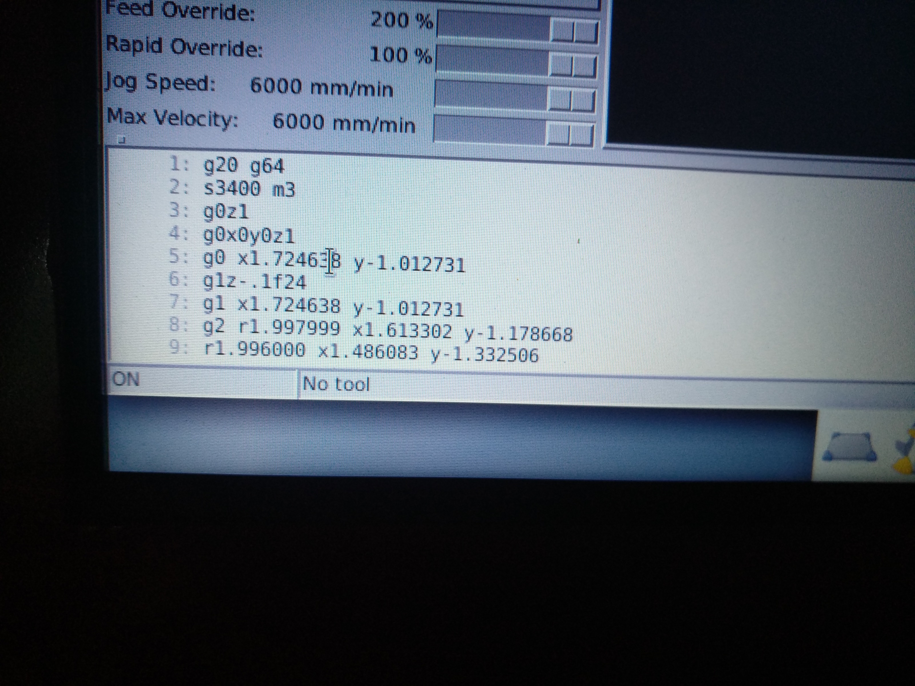

- phoenix
- Posts: 157
03 Jul 2019 07:00 #138496
by phoenix
Replied by phoenix on topic Pointer not jogging on linuxcnc axis ui
Its not moving forward this line
- Posts: 21958
- Thank you received: 7478
03 Jul 2019 09:30 #138503
Replied by tommylight on topic Pointer not jogging on linuxcnc axis ui
ARCOK signal is not wired or has to be set as NOT in hal.
Also you have Z values in that file and very wrong one at that as you have Z-.1f24 ????? How did you get that value? Nevermind, just delete lines with Z values.
THC_toma will not move the machine without a propper ARCOK signal.
S value can be any number.

Sir will u kindly explain what do you Mean by wrong z values??
- Posts: 21958
04 Jul 2019 11:59 #138620
In your gcode you have a value of Z-.1f24
That is not a valid value.
And having 5 threads for the same problem is not helping.
