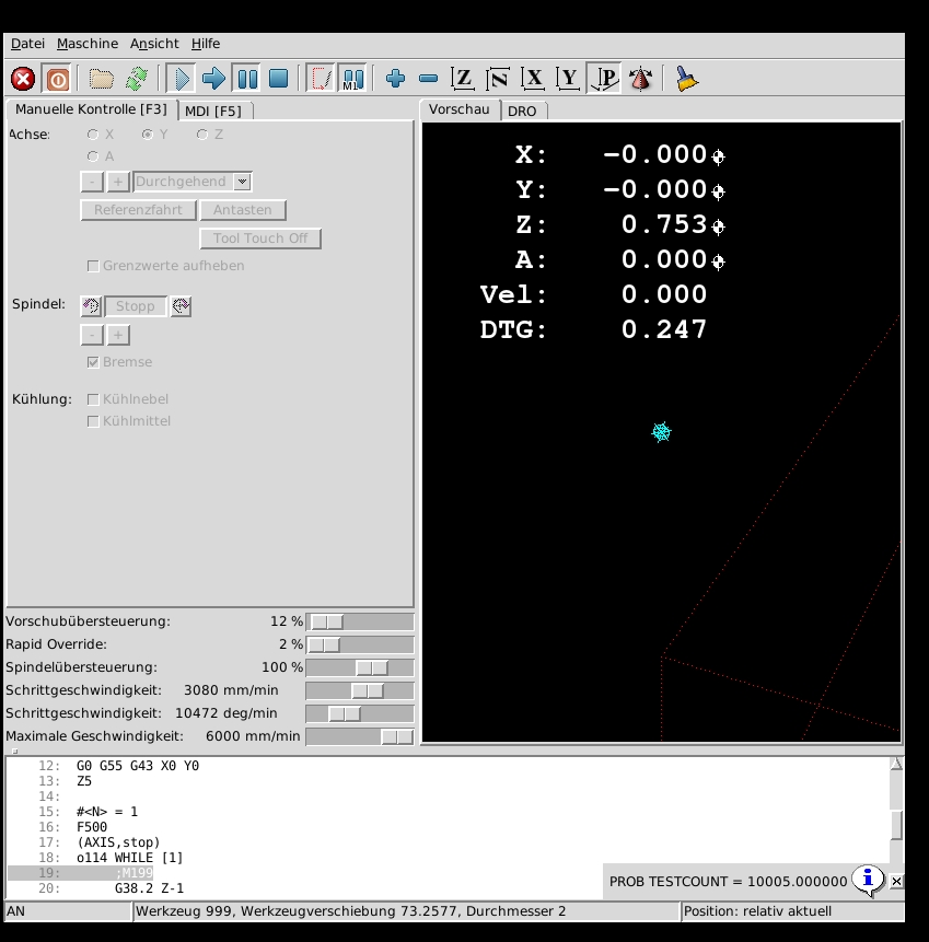

24 Nov 2019 02:26 #151089
by MaHa
Replied by MaHa on topic Queue is not empty after probing
After probing 10005 times, i was bored waiting for the error, then aborted. The code is simple z probing at same x y position, without loging, only debug the testcounter.

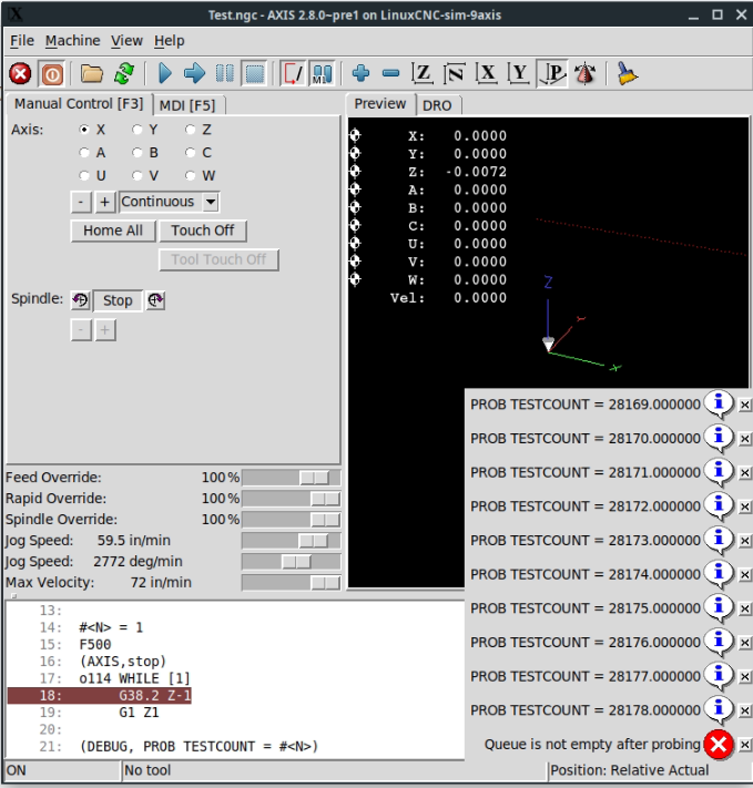

24 Nov 2019 15:28 - 24 Nov 2019 15:33 #151118
by grandixximo
Replied by grandixximo on topic Queue is not empty after probing
Took 28178 probes but it came out, i know it may take a while, sometimes hours, but it will always eventually come out, let it run trough the night, you don't have to stand there watching it...

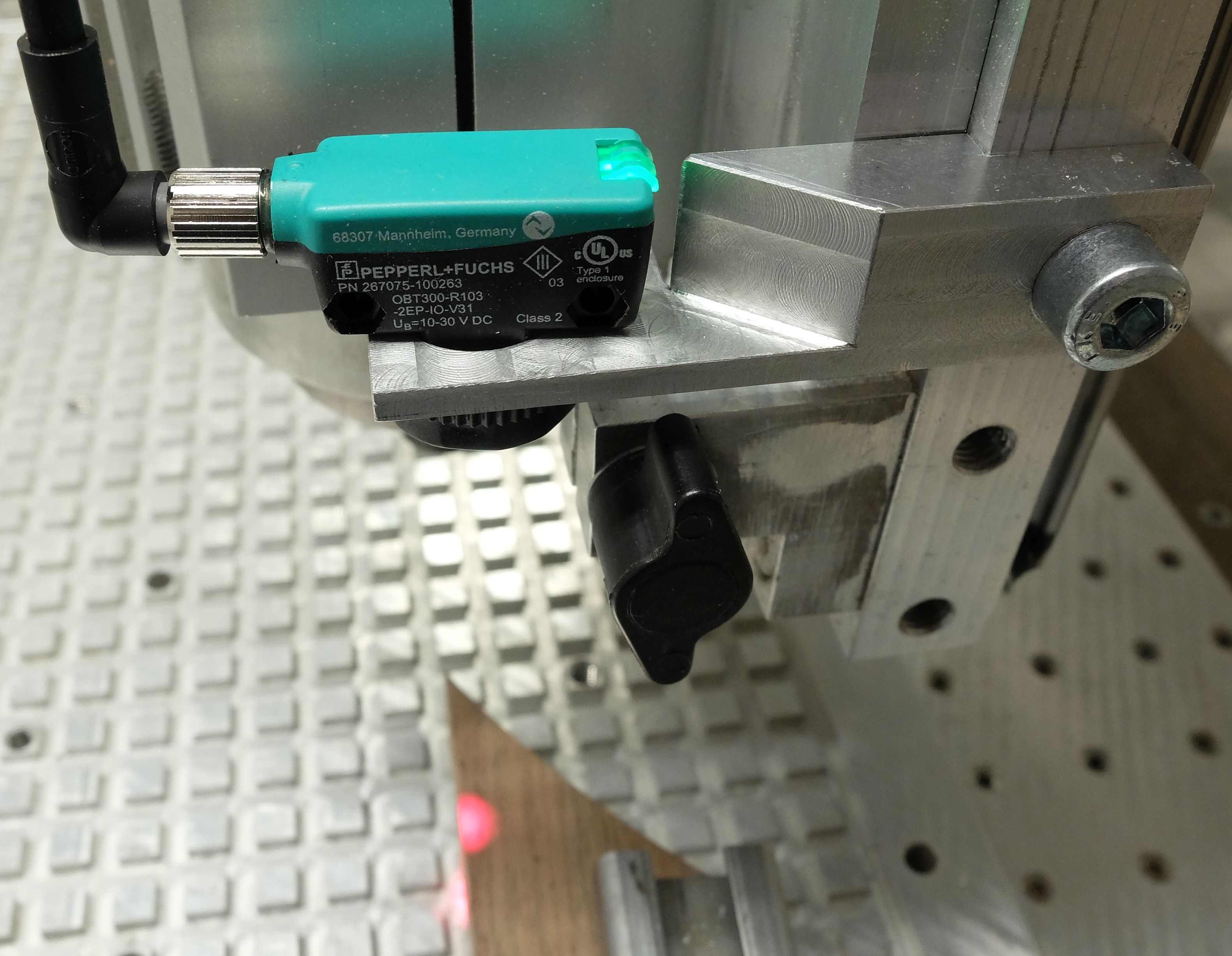

24 Nov 2019 22:28 #151151
by MaHa
It is impossible for me, to evoke this error. This time probing 36000 times, also on release, G38.4, so it was 72000 finally. As I did not want to use the touch probe, I rewired the triangulation sensor to do this test. It's a bit picky about the material used. Wood and non glossy surfaces work well, but with polished steel or aluminium the results are not trustable. The other thing is, because of the construction, there is one direction to approach the edge, maybe from opposite side results loose accuracy. Sidewards is useless to do, if you want usable results.
For this test, there was a travel distance to trigger, G38.2, about 0.65mm. The release trigger, G38.4, was in the area of 0.07mm, so the hysteresis of this device is roughly 0.6mm from trigger to release, F500 programmed.
If someone is interrested for the repeatability, there is the logfile. Unfortunately I only saved the release trigger, which is less accurate. Telling about this sensor, is just to describe the setup used. As i am unable to produce any error while probing, i stop testing.

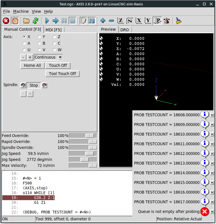

Thank you very much for spending time testing this, it's really amazing that the error doesn't come up to you, haven't had a setup without error.
What kernel you using? what version of linuxcnc? what hardware is it running on? motherboard cpu ram...
I ran the same code as you trough the night again and it came up again with the error after 18617 probes.

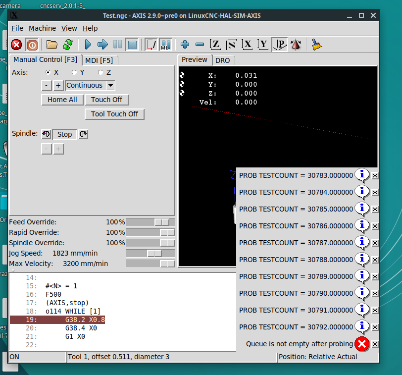

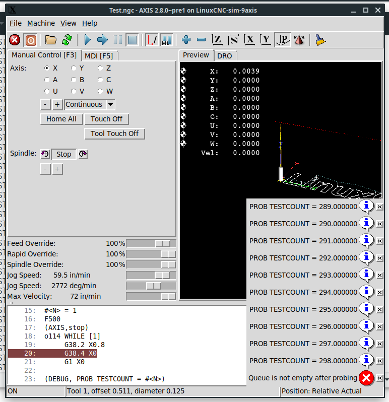

25 Nov 2019 06:53 - 25 Nov 2019 07:52 #151197
by grandixximo
I tested your new code on my setup, error came up after 489 probe the first time and 298 probes the second time, that's the quickest i have seen on my setup, i have no idea why it's not coming up for you...
EDIT:
Maybe i have an idea why, i built linuxcnc 2.9 from github that i downloaded a while ago, and seems like the error is not coming up as quickly, i got to 30792, what version of linuxcnc are you using? i'll try with the latest master..
EDIT:
