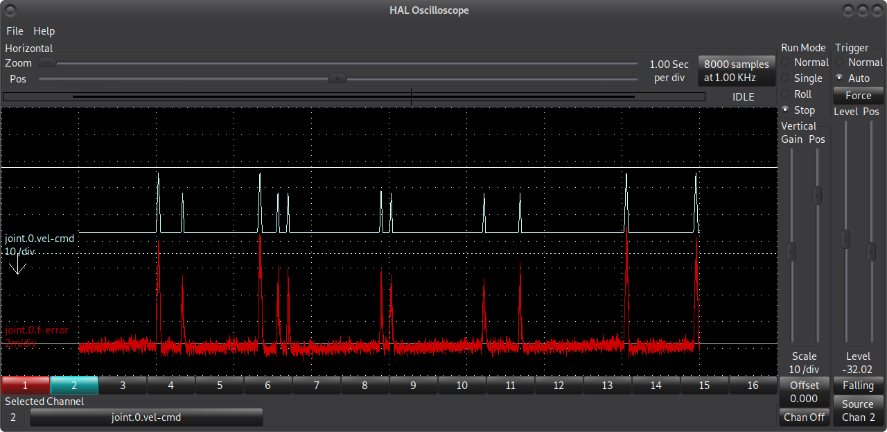

As the title says, the jog velocity fluctuates, while gcode movement is not affected. Build 1610.
Here is a short video.
Solution found by PCW :
in a terminal type
xset -r
That will get rid of fluctuations.
Thank you PCW
To make that permanent find "startup applications" from the menu, then add and put xset -r in the command field, close and reboot.

This seems to be hardware related, not software. Had the same issue on another PC, but not on many others i have.
Some quick results:
Linux Debian or Mint has no influence, happened on both.
Linuxcnc 2.9 build 1350 on a Dell, no issues.
Linuxcnc 2.9 build 1427 on a Lenovo laptop, no issues.
This older HP core2duo does that with 3 builds, 1610 and two earlier versions.
First instinct was to look at the keyboard, as many of you pointed out, but it looks that the keyboard is not causing that as the same keyboards on the other PC's jog happily, and i have tested some 5 or 6 of them with PS/2 or USB connectors, does not change a thing.
This is most probably the "typematic rate' setting that was adjustable in older BIOS, but it is not on the new ones. Same thing happens when holding down any letter key, the speed of printing it on screen fluctuates !!!

is it possible to check the input of the keyboard command with halscope? I have not messed with Master or 2.8 much, but I have seen such behavior on other versions of Linuxcnc when trying to control it via remote desktop (VNC).
- Posts: 18093
- Thank you received: 5325
26 Apr 2020 17:32 - 26 Apr 2020 17:33 #165676
Replied by PCW on topic Linuxcnc 2.9 jogging velocity fluctuations.
I would guess its a keyboard issue also since the error is from motion
You could also check to see if the drops in velocity violate the acceleration
constraints (by plotting at a lower time per division and checking the slopes)
Another thing to try is to see if pure hal jogging shows the same issue
(maybe just setp-ing the correct halui pins with halcmd)
BTW I cannot duplicate this with keyboard jogging and LinuxCNC 2.9 here
Some quick results:
Thank you all for continued support, it is very much appreciated.
Marking the topic as solved.
