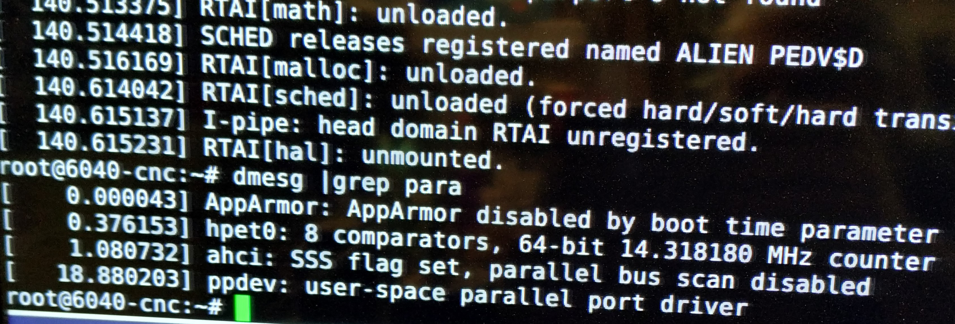

It was working but I tried a new BOB as the one I had was failing and well I am wondering if the new BOB damaged the PP card?

The Bob has a seperate 24v dc supply. PCI add on card
dmesg (dmesg | grep para) doesnt show a paraport

Actually sorry my error should be dmesg |grep parp NOT para
so its there just not working?
