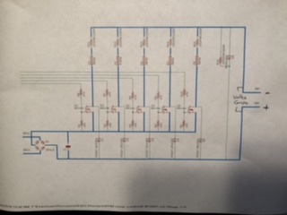

I am using a 7i84D in mode 2 as a remote card for a WIRE EDM project. I need to read the voltage to adjust the feed rate. I have a THCAD-300 connected to the spark box voltage and it outputs a square wave signal confirmed by an oscilloscope and reading hal scope reading 7i84 encoder 0 A phase. without a B phase the count will not work. I've tried several commands to change the counter mode to 1 like std encoders to ignore phase B. Is this option not available? Is there another way to achieve this. I have hooked up an mpg wheel and can see a count so the card is working. The card layout is 7i96 with 7i73 pendant on serial and 7i85 on the 7i96 expansion port with the 7i84D on its serial.
Thanks in advance
Thanks in advance

That would require adding a long cable from the spark box to the control box. This something I was trying to avoid. Could I instead measure the voltage via the analog inputs use a voltage divider? Max voltage would be 160 DC.
- Posts: 18056
- Thank you received: 5306
27 May 2020 17:25 #169138
Replied by PCW on topic THCAD via 7i96-7i94D mode 2 mpg encoder input
Is the 160V common close to ground potential?
Is it + 160V?
Is it + 160V?
- microsprintbuilder
- Posts: 115
- Thank you received: 4
27 May 2020 20:37 #169152
by microsprintbuilder
Replied by microsprintbuilder on topic THCAD via 7i96-7i94D mode 2 mpg encoder input
yes, if you mean its DC positive.
- Posts: 18056
27 May 2020 22:59 #169164
OK then you should be able to read that with the 7I84/7I84D
A 75K 1% resistor in series the input should give you
about 160V full scale

28 May 2020 11:28 - 28 May 2020 11:29 #169216
Last edit: 28 May 2020 11:29 by microsprintbuilder.
