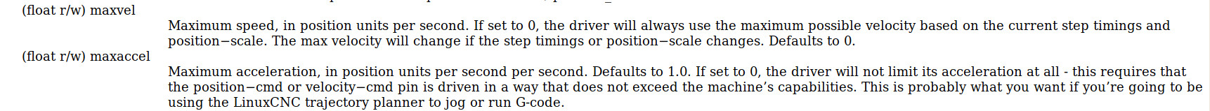

I have a bar loader configured as a U axis in a mill configuration using stepper motors. This u axis, unlike all other axis, is a direct drive rack and pinion. Because this feeder has a travel length of 4 meters I want to increase the G0 rapid velocity by about a factor of 10 without affecting the settings of the other axis.
Now I got myself confused about all the different velocities and acceleration settings in the INI file.
So we have this in the DISPLAY section:
this in the TRAJ section

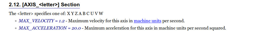

this in the AXIS section:
this in the JOINT section:

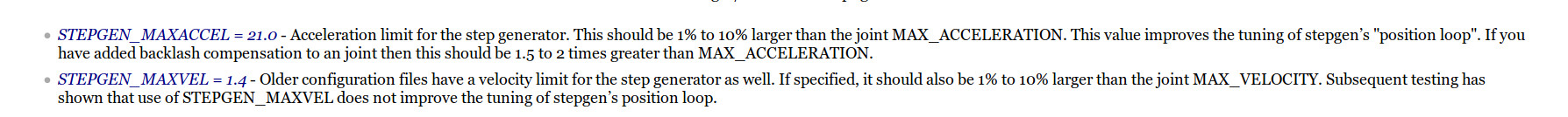

and this in the joint section that is actually for the hostmot2 stepgen
So my understanding is that in JOINT mode (so also for the homing process since there is no axis before the joint is homed) the settings in the JOINT section are relevant. After homing it is the AXIS section.
So then in the DISPLAY section we set the min/max values for the jog slider in the GUI and the TRAJ setting are for the motion planner.
So in order to increase the G0 velocity for the U-Axis only I should just be able to increase the settings in the U-AXIS section.
I tried that but it does not seem to make a difference. The U-AXIS still moves at about 25mm/s.
Because the machine is already in use I can't spend to much time fiddling with it. So I would like to have a somewhat clear understanding of what my approach should be.
So should I increase the TRAJ velocity and the JOINT and the AXIS for U? Should the settings in the JOINT and AXIS sections always be the same?
