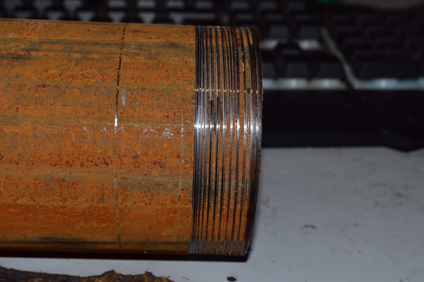

Hello.
I have been using the system not so long ago, maybe since 2014, and I cut a lot of threads. And I was always wondering why they do not always turn out smooth? What settings should be on the lathe, which encoder, what rotation speed?
I tried to increase the distance in front of the thread to stabilize the speed. I tried to exit the thread a multiple of the thread pitch and the length of the thread a multiple of the thread pitch.
it still turns out very badly.
Please teach me how to cut the thread correctly.

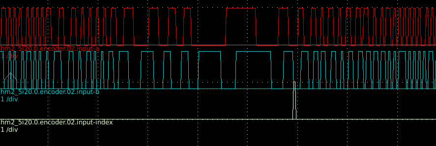

15 Jul 2020 23:34 #174780
by pkasy
Replied by pkasy on topic The question of proper threading
the video turned out to be of poor quality, since there is no tripod for the phone.
but here is a screenshot of the signals from the encoder when I rotated the spindle by hand. as you see, everything works.
but the cutter stands still and waits for something. sometimes jumping, sometimes follows.

16 Jul 2020 06:35 #174806
by Clive S
Is the encoder counting the correct way ie is it increasing +ve when turning the spindle
Replied by Clive S on topic The question of proper threading
The following user(s) said Thank You: pkasy
