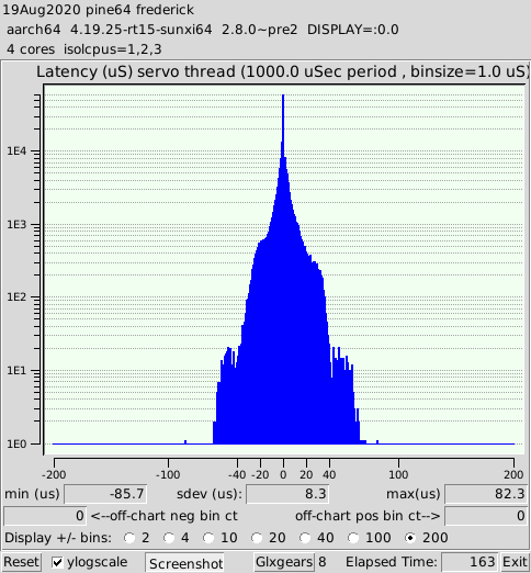

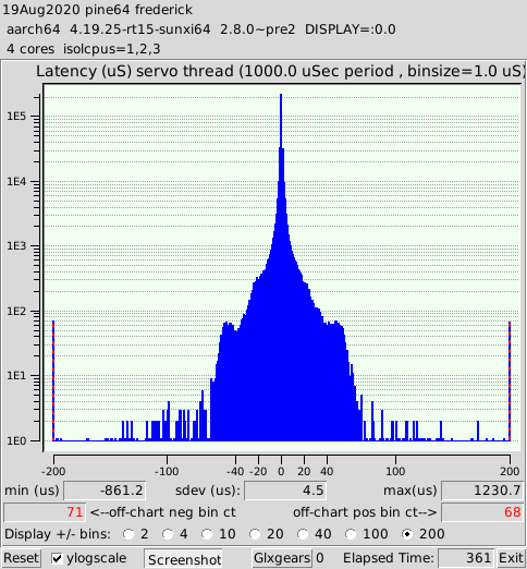

Just like the title says, my latency spikes when my system isn't under load.
I am running a pine64 on armbian with a preempt-rt kernel.
Attached is the Latency Histogram for no base, no load, no base heavy load.
The standard latency test has a max jitter of about 50,000 when under load or when running that base thread.
Any Ideas as how I can fix this? I haven't really seen anyone use a pine before. It a 4 or so year old board so there is probably a reason why.

I set the cpu governor to performance and the latency looks alot better when not under load.
Given the latency histogram when the pine was under load, would that be usable for a system with a 7i76e?

Yeah. My result looked just like the graph under load. If it inst good enough, I'll try to overclock the system and see if it improves.

Nothing seems to get it down much lower. I'll just switch my focus to the pi 4 which has been done before.
- Posts: 18111
- Thank you received: 5330
19 Aug 2020 23:48 #178778
Replied by PCW on topic Latency Spikes With No Load
The 80 or 90 usec seems ok
Do you have a Mesa Ethernet card to try?
Worst case you may need to run at 500Hz servo thread rather than 1 KHz
(This is normally OK unless you have a very high acceleration machine)
