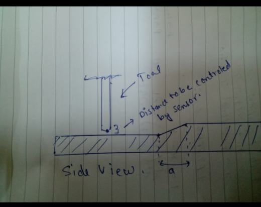

14 Sep 2020 22:44 #182159
by saztyga
Sorry for the late response sir, i am trying to make cake decorator so there may be ups and downs on cake surface
so that's why i want to put sensor on z axis so it can move tool up and down during execution.
here is a picture
where A should be read by sensor and moves the tools accordingly ..please help me out with this.
Thank You sir
Replied by saztyga on topic z-axis movement via ultrasonic sensor
here is a picture
Thank You sir

19 Sep 2020 08:08 #182717
by Himarc3D
Replied by Himarc3D on topic z-axis movement via ultrasonic sensor
I dont think its easy for cake...youll take a lot time to adjust it, for metal people use one method called breakaway, when the nozzle colide with the work material the nozzle breakaway from the support, in your case maybe it drop up the cake...i saw here one guy use wire to avoid it to drop...whats 3? 3mm, 3cm or 3 inch? why you need one machine to do it? 3cm will be more easy to implement.
The sensor work. Actually the machine dont have idea what sensor you are using, just signal and if the signal was consistent or not.
You wanna real time height adjustment?
Do you have 3D printer?
If no check bed leveling in 3D printer, someone here started talk about 3D printer but i think stopped talking about it, search here in the forum.

19 Sep 2020 08:13 #182718
Replied by tommylight on topic z-axis movement via ultrasonic sensor
Ultrasonic sensors will most probably not work for that as the area they detect is quite big, or the head will move up or down way before where it is needed.
A laser range finder would be to narrow, so again not really usable.
I would still try with ultrasonic sensors but add short tubes in front of them to narrow the field, that might still work.

19 Sep 2020 08:29 #182719
by Himarc3D
Ultrasonic sensor have mm to meters circumference range. In industry now i saw a lot people using fiber now.

19 Sep 2020 08:34 #182720
by Himarc3D
The material surface will be pretty trick i think using ultrasonic.
