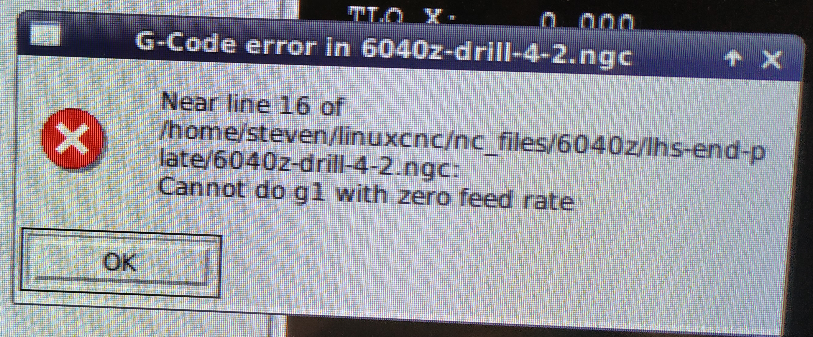

So f360 free / personal edition, yesterday I drilled these same holes OK.Just now I re-post processed and today I get errors when trying to drill and well I have no ideas, Google returns nothing. Since Autodesk messed with the feedrate of the "free" edition I am wondering if its a cockup in coding?
"N55 G1 F0." seems to be the offending line? can I change this manually? if so too what? I assume there are other lines....?

The 2 or 3 places with F0 can I make them F291?

re. N120 G1 Z15. F0. This is just saying move to Z15 at zero feed rate (so won't do it)
So change the zero for some rate that your machine is happy with ie F75
where did F291 come from?
