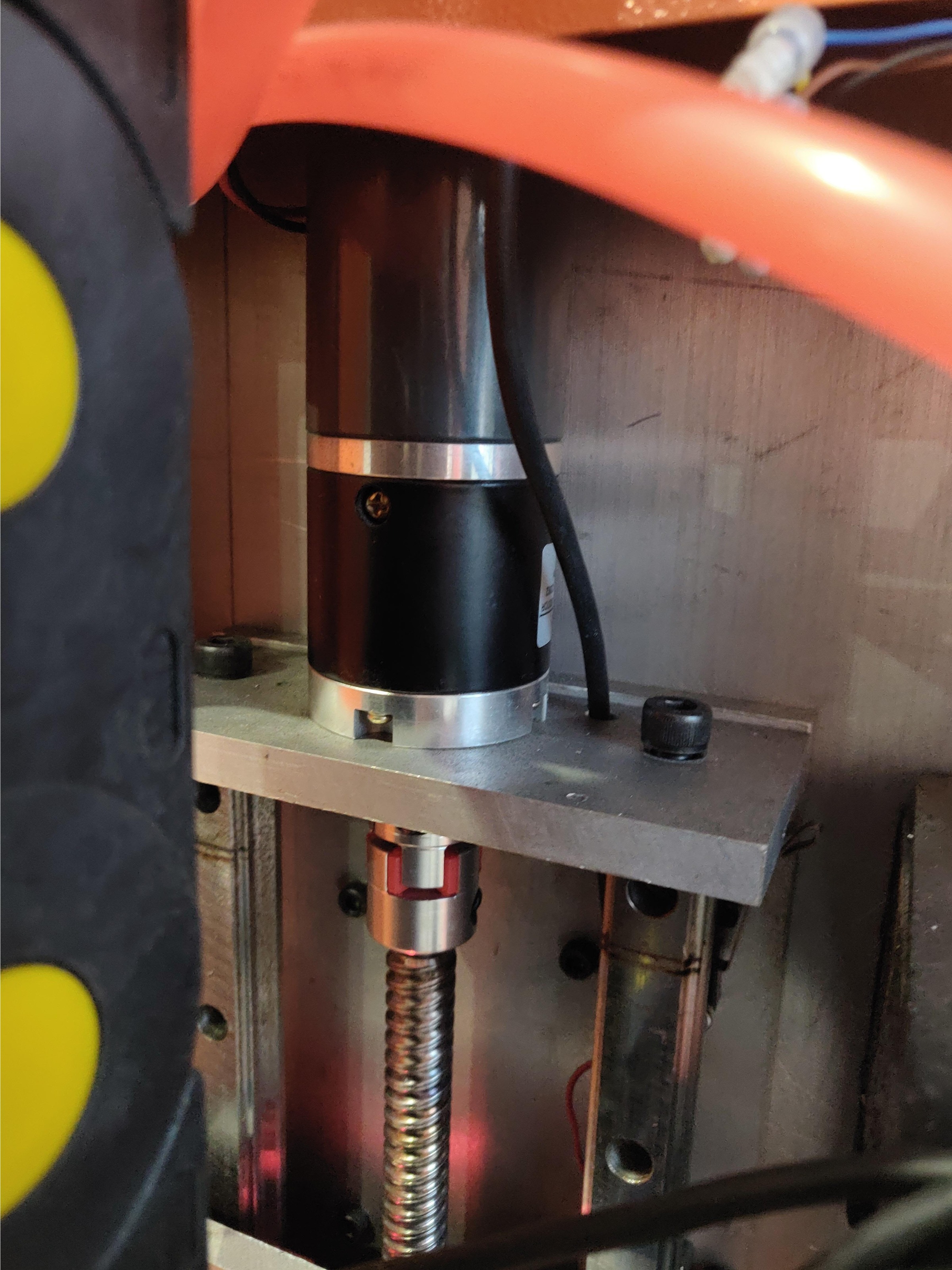

Looks like I need to upgrade my z axis as it's currently running a DC motor. Just wondering everyone's thoughts on Servo vs Stepper. The machine has 400w yaskawa servos on x and y (2 on y, 1 on y). I've done a bit of research and I feel like nema 23 sized servo's would have to be up to the task. Looks like Gecko is the best for a stepper driver, but I can't seem to figure out the whole motor situation.
Are all nema 23's the same or is there a particular brand I should be looking at. I've noticed 'sure step' which seems to be a quality motor, does anyone have experience with them and a gecko driver? I'm after as many opinions as possible so please feel free to share what you think.
I will post some pic's tonight when I'm in front of my computer.

I'm sorry. I've been a bit the same. I would not get a Gecko servo driver as Stefan had a lot of problems with one and gave up.
If you went with a stepper, I would recommend a Lam Technologies LS1073a driver I can source, and a
Sanyo Denki NEMA24 (60mm frame) motor which I have in stock. I bought about 20 of them so ignore the price shown on that page. For a power supply, I would suggest a 50V 3.2 amp toroid which I have a source for..
I've got a matched pair ESTUN EDC servo driver (step/dir) and a matching 400 W servo motor with a 60mm frame on hold for you with a trusted Aussie supplier. The power is a good match for a Z axis based on our stepper model. The advantage of using a servo is that it will run on mains power so you do not need to buy an additional power supply to drive a stepper. It will cost a bit more but be a cleaner setup with the existing yaskawas
A question for the others. This servo motor has max torque through to about 3600 rpm. I did not think it would need a gearbox reduction, so what do others think?

Is it for the Z with a ballscrew? If so then direct drive should be ok. Rack and pinion forget it. I already went through hat and had to buy planetary gears becasue my pinion was too big and I have 750 ac servo's with a load of no more than 25lbs.

Yeh, Greg has a Ballscrew on the Z axis
I thought it would be OK direct drive but would have been reaching for a gearbox for a rack and pinion
