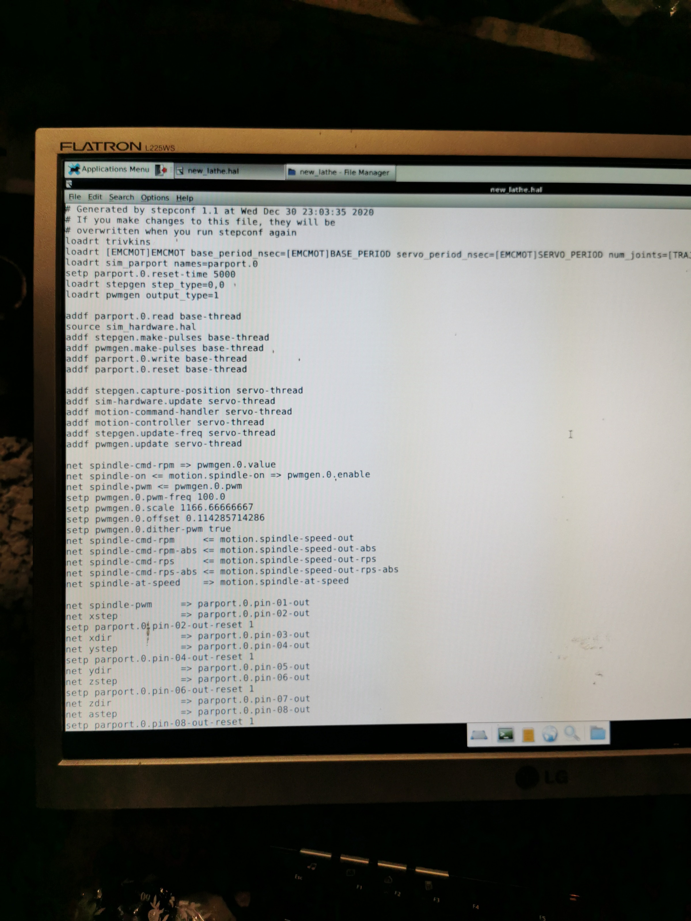

Can you post the hal and ini files from the config folder.
Edit: looking at the the picture of the hal file it looks like you are loading a sim "simulation"

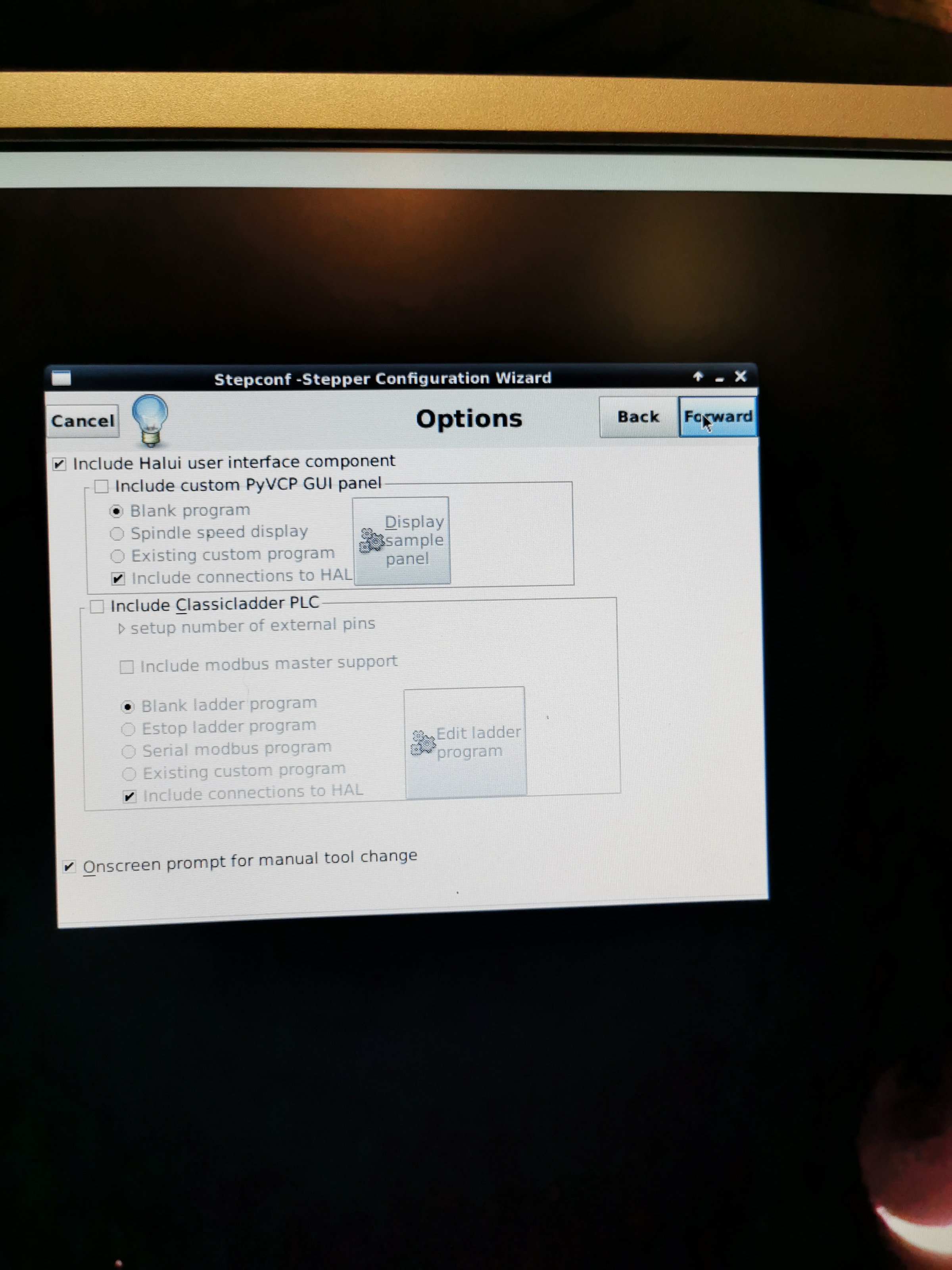

- Thompo
- Posts: 11
31 Dec 2020 09:55 - 31 Dec 2020 10:17 #193622
by Thompo
Replied by Thompo on topic Motors moves in stepconf but not machine...
Thanks that could make sense as it is doing everything but moving lol.
Here are the files requested, I do see a sim_hardware.hal file
#EDIT -
Re-ran stepconf to create a new file and unticked the create hardware simulation.
All works as it should.
Like i said im new to this lol.
Thanks for your help.
#EDIT -
Last edit: 31 Dec 2020 10:17 by Thompo.

In case you or any one else need to know how to fix this, look on the start page for
'create simulated hardware configuration' checkbox -uncheckit
