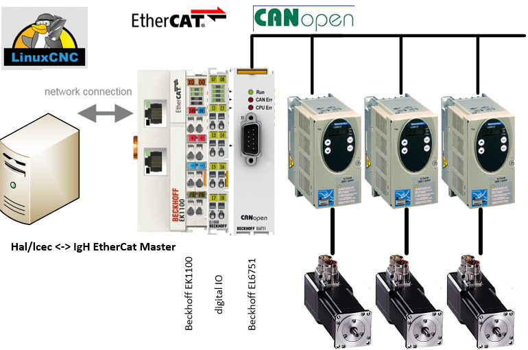

Good morning,
I'm back here to ask you for advice.
We need to retrofit a machine where the drivers and motors are yet on board. Is it a gantry solution with DELTA ASD-A3 drivers+
X(400W) Y1(1KW) Y2(1KW) Z(1,5KW+brake) + A ( 3 KW) + VFD spindle.
Which hardware and which way to manage all the motors do you suggest to me?
Do you think that EtherCAT communication would be a possible solution for linuxcnc?
If yes, which hardware you can suggest to us?
I have experience with a MESA 7i76e board but I think that the basic communication with STEP+DIR doesn't consent us to take all the advantages of this fancy drivers solution.
Thanks in advance

11 Feb 2021 10:19 #198376
by AlessandroT
Replied by AlessandroT on topic LINUXCNC + DELTA ASD-A3 - hardware and comunication advice
Thanks Arvidb,
for the reply.
I was wrong about the Ethercat. Drivers can't accept Ethercat but they can accept these following communication ways in which there is the CANopen:
Type
PT Mode PulseTrain
PR Mode
RS-485
CANopen
Fullclosed Loop Control
Analog Voltage Control
E-CAM
STO
Which one would you suggest to us with linuxcnc that will manage 5-9 axis?
From the link that you attached, I saw the following image.
I'm not expert at all, so my question is:
If linuxcnc can talk via Ethercat through a Beckhoff component and it can talk via CANopen to motors driver, how many axes can manage?
It will be possible to develop a reliable system in this way?
Thank you in advance
Kindly regards

- Posts: 19896
- Thank you received: 4648
11 Feb 2021 19:16 #198427
Replied by andypugh on topic LINUXCNC + DELTA ASD-A3 - hardware and comunication advice
General Mechatronics might have a CAN bus system:
www.generalmechatronics.com/linuxcnc.html
But there are lots of ways to interface with pulse train (ie step/dir) or analogue voltage control.
- AlessandroT
- Posts: 49
11 Feb 2021 21:56 #198451
by AlessandroT
Thanks andypugh,
I will write to that company to understand better their CANopen solution. I read on their website that their solution works till 6 axes. Maybe do you know also other companies that sell compatible CANopen-linuxcnc hardware?
Thanks in advance
A.
Thanks in advance
A.
