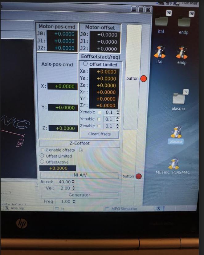

Replied by tommylight on topic Linuxcnc with Computer Vision …
No need to change gcode for that, have a look at external offsets, should be much easier to get to what you need.
linuxcnc.org/docs/2.8/html/motion/external-offsets.html
PlasmaC should be already using external offsets to give you a starting point.

Hi .. Tom
This is a good advise to start , but as I watched some video , all external offsets was controlled manually , as explained i will use it for a welding machine as a tracking sensor for the welding gap ... still the idea not clear for me how to integrate the feed back from openCV to external offset to effect the motion of x, y simultaneously .

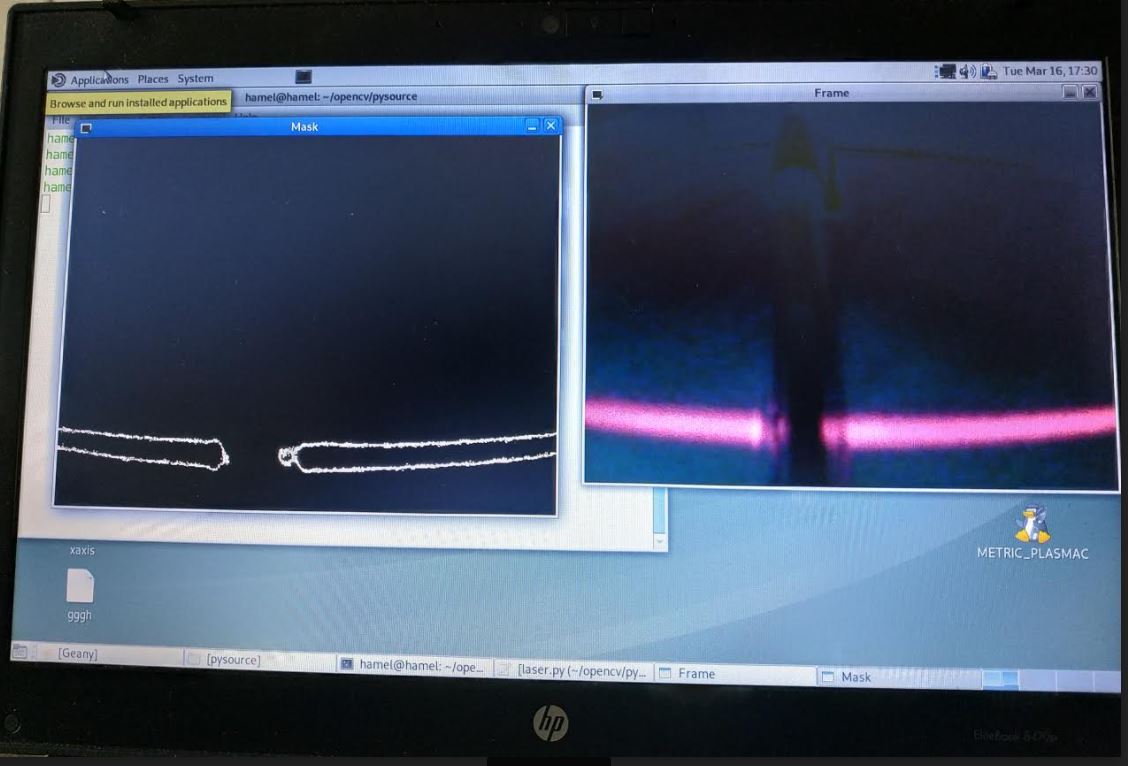

Hi …
Actually I’m still working on it … I was able to read the distance (gap-welding width) between the two plates as the photo , I used the external offset as Tommy advise , but the offset examples in axis is limited specially for sine oscillating motion damping in Z-direction , ( this will be helpful in case of plasma cutting ) but for welding need damping in XY-direction .
Still I need the convert the image reading into a voltage signal to indicate the max_lim and min_lim for the damping oscillating .
I used opencv and python
